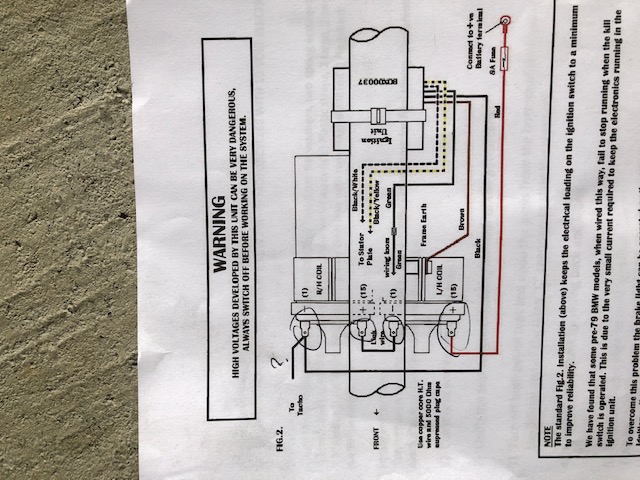

The Boyer unit is micro digital for Pre 79 BMWs - red box.
The install is as in the attached diagram. I has the green wire from the loom attached directly to the green wire from the box. I did not install this, but it seemed to work before. I did take apart to re-route the wires some to make it a little neater, but the only wires I disconnected were the ones attached to the coils. As you can see a red wire (separate from the box) from the battery goes directly to the LH coil +. This would supply the power to the coil. The the piggy jumper between the coils are connected. The black from the box to the "-" of the RH coil is on and the brown to ground. There was no other wire that went from the RH coil "-" to ground/tach. Not sure what that is for? Note: On the second tab on the RH "-" coil, I put a wire on it from the Endurlast alternator rectifier unit/box as instructed.
I also tried these tests that were suggested by someone else: I also took a magnet, turned on the ignition switch and skimmed over the magnets on the pickup plate, which should give a spark to the plugs, when grounded to the cylinder. I also disconnected the two wires from the pickup plate and touched together which would also produce spark. Nothing in either case, if I did those tests correctly.

- Boyer Install.JPG (118.74 KiB) Viewed 3536 times

Just looked through the relevant Boyer instructions. The test I suggested before are still valid although, with the red wire hard wired to battery + you don't need to bother about the ignition switch. You do, though, need to check that the green wire goes live when the ignition switch is turned on.
