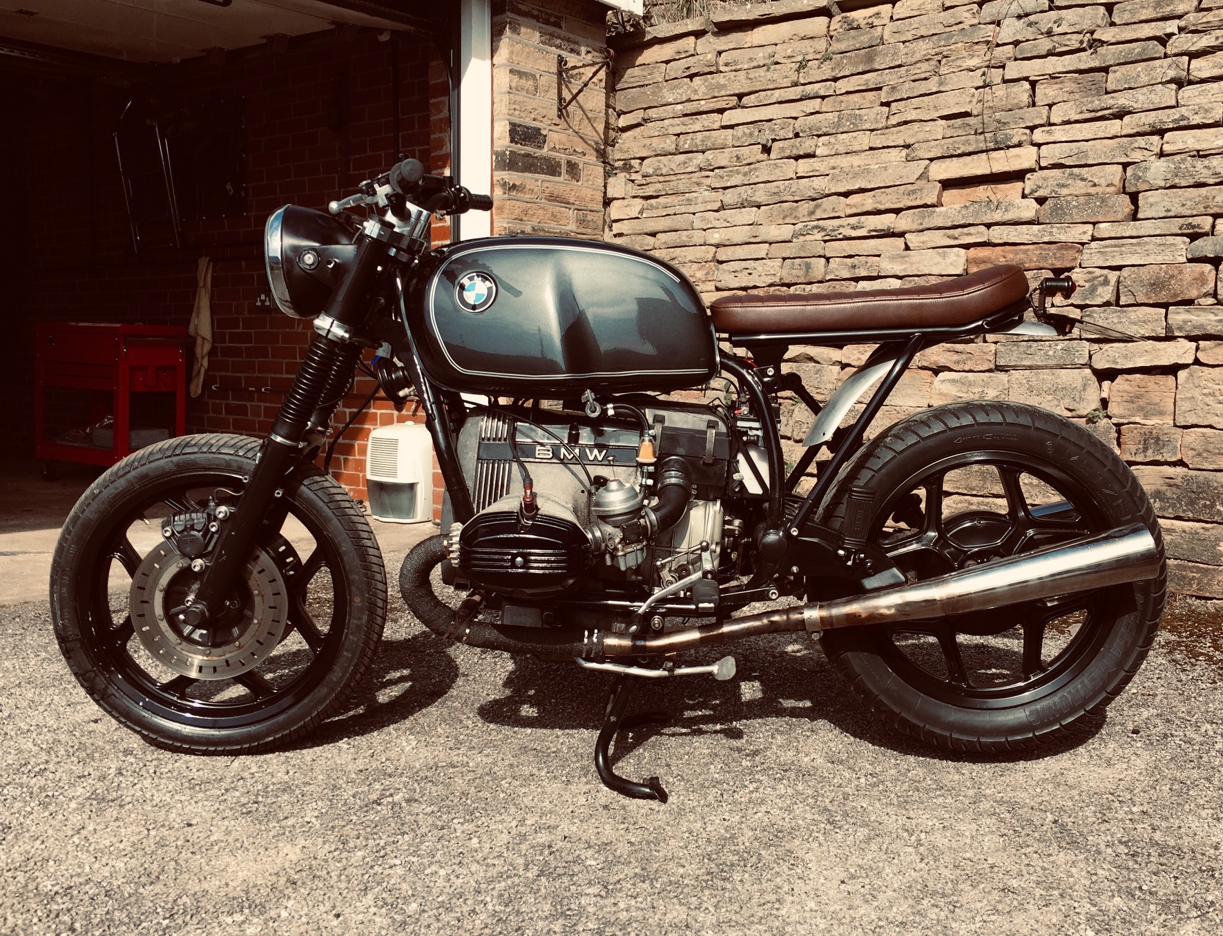

Hi,
Has anybody got any idea why my left cylinder on my R80 won't run properly. I have very little experience of these bikes but do have reasonable mechanical knowledge.The left hand cylinder is running but won't rev properly. I've connected a vacuum gauge and the right cylinder at tick over is pulling about 160mm vacuum but the left cylinder only about 30-40mm vacuum. Adjusting the mixture screw has very little effect.

- IMG_0079.jpg (1013.21 KiB) Viewed 2286 times

Welcome to the board! I hope you work out your running situation. I have nowt to add but some admiration for your build. I have an incomplete R75/6 that may get a similar minimalist treatment. Thanks for some inspiration!
Re: 1986 Monoshock R80RT Running problems
Thanks, it’s a really simple build. Just a new rear subframe, seat and a load of motogadget stuff.
