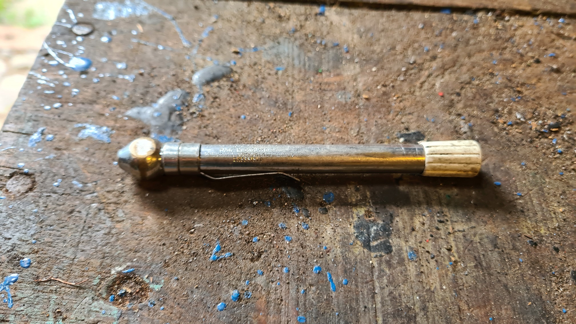

I order these by the dozen.
Works out to less than a buck each, including delivery.
Don't mind losing them or giving them away.
Readings are consistently accurate, believe it or not..

Pen type tyre pressure gauges have been around for ever (well certainly for 50 odd years to my personal knowledge). The question has always been one of how accurate they are (and, of course, how accurate they need to be ;) ). The truth is that they aren't very accurate, none I have seen are calibratable and their accuracy tends to suffer from being bashed about in a bikes toolkit for long periods. That being said I do have one and I still occasionally use it as a quick roadside check. Wouldn't want to rely on it for setting pressures though.
I would say that the one below is over 40 years old and, out of interest, I just looked online. A virtually identical gauge is still available from the same manufacturer (PCL). That shows a design continuity that puts even airheads to shame... 8-)

I use a PCL pencil type gauge and there is no reason they can't be at least as accurate as a dial type pressure gauge, in fact fundamentally they are potentially more accurate due to the simplicity of construction which is a piston and an extension spring where as the bourdon tube dial gauges need a mechanism to convert linear movement of the bourdon tube to rotary movement. Cheap bourdon tube gauges are not very accurate particularly at the bottom and top 10% of there range and this is usually compounded by an unsuitable choice of gauge range e.g. 0-100 psi when a 0-50 PSI range would be inherently more accurate and enough for most domestic use. A pencil gauge can be adjusted by simply unscrewing the head and altering the effective spring length using the spring anchor.
I say the above having been trained in instrument calibration.
Re: Good idea?
I have tested a few digital air gauges, and when comparing them with my best pencil gauge seem to be pretty accurate. I always try to err on the side of too much pressure.
