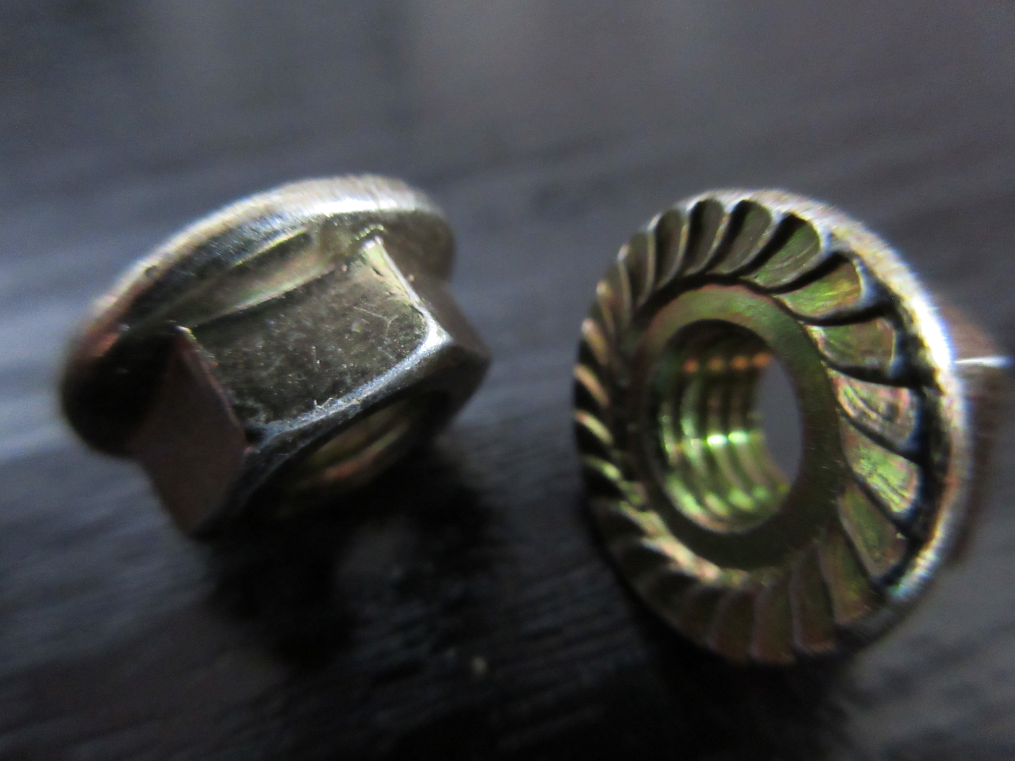

I use these (pic below) instead, much easier, just as secure.
Makes valve checks even easier and quicker than they already are.
Also, if used on things like saddlebag mounts, etc., you don't need a spanner to hold them while tightening the bolt, just a bit of finger pressure needed; they grip the surface and don't turn while you tighten.
Never had one come loose on its own.
Available at any auto parts place, probably for less than BMW charges for the washer alone.
You're welcome ;)

I've always had two wave washers under those cap nuts. Is that the way they came?
Re: 07 11 9 932 099
The part number gspd gives shows a total of 8 required for my /7. That indicates two per stud. But only shows 4 total for my R69S.
Re: 07 11 9 932 099
Hmmm,
curioser and curioser... the BMW parts lists show 8 washers for machines up tp 1984 but from 1985, they only list 4 - same part number. Can't think of any reason why you would want to put two washers on that stud (except to test the patience of DIY mechanics)... I know I never have and have had no ill consequences...
