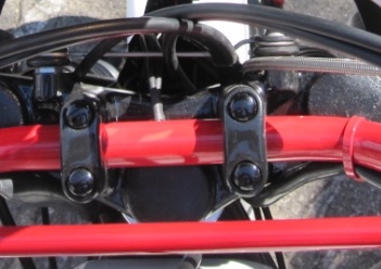

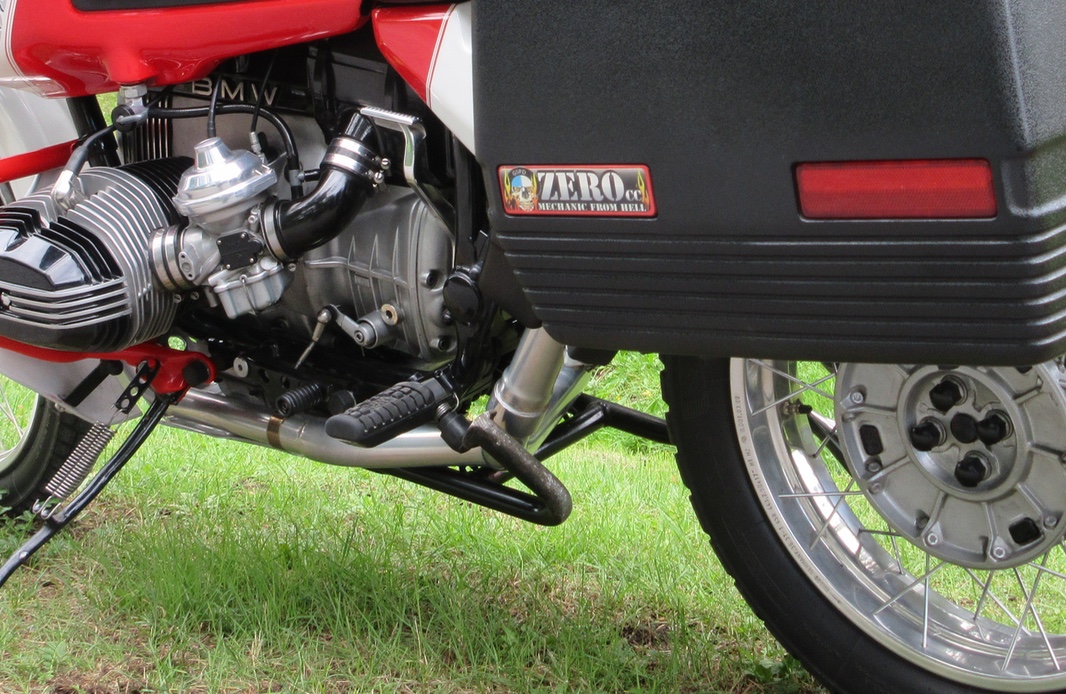

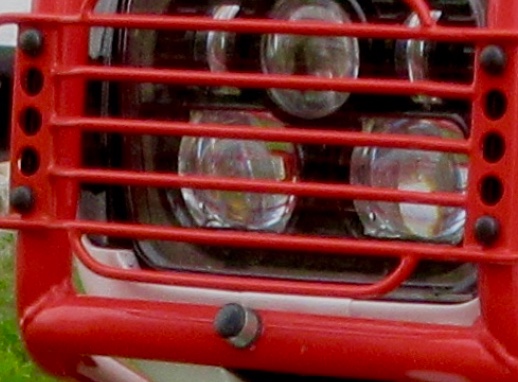

While we're on the topic of nuts and bolts and how crappy they look when corroded, I'm going to let you all in on a little secret. I was going to take it to my grave, but I decided to share it here...
Everywhere I go, especially if there are other beemers around, I get tons of comments on how super clean and new looking my bike is. I am often asked: "How do you keep your bike so effin clean?"
Well here's one tip that makes it A LOT easier (and remember you heard it here first).
drum roll please....
PUT A PLASTIC CAP ON EVERY VISIBLE FASTENER.
They protect the finish, keep dirt and rust away, and make cleaning a breeze.
I put a bit of grease on the bolts before capping them.
Nothing's harder to clean than allan bolts packed with dry mud after a trail romp.
Plastic caps are definitely not 'nazi OE concours' but nobody ever seems to notice them, and I've got them everywhere:
Calipers bolts, disc bolts, engine mounts, saddle bag mounts, wheel bolts, pretty much everywhere.
Even on an old /5, the caps just seem to disappear, where as rusty bolts stand out like a sore thumb. It seems like a no-brainer to me.
The only negative issues I can think of is that they won't pass the analoriginality test, and it adds a few grams of weight to the bike.

Very cool, thanx for sharing. Where's a good place to buy those covers?

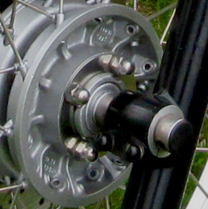

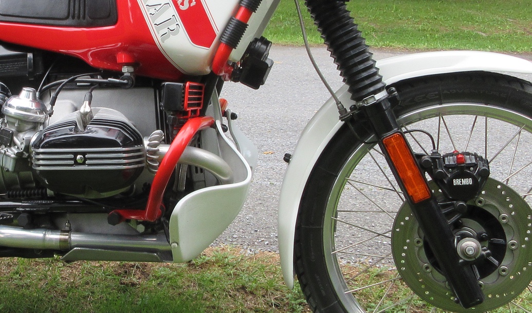

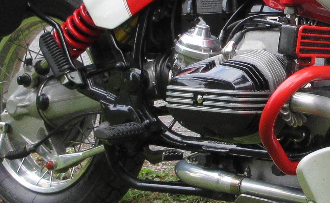

Aliexpress has a wide array of stainless fasteners.Rob Frankham wrote: ↑Mon Nov 01, 2021 6:43 am My approach is to replace everything possible with stainless. A2 for most bolts and A4 for anything critical. Unless you are set on the polished heads that mean you have to buy them from a dealer (at a vastly inflated price), stainless fixings in just about every size and type imaginable are available for a few pence (cents?) from fixing retailers or wholesalers. Check out the local business parks (industrial estates, business districts... whatever) for the little business that supplies fixings to other local businesses and walk in.
Stainless steel acorn nuts can also be used to protect protruding threads if you have a pre-undisposition to plastic.
They also have many types and sizes of allan bolt plastic plugs.
I also replaced my trans and diff fill and drain plugs, stand springs, shift linkage rod, rear brake adjuster nut and bushing, and a few other bits that always rust with stainless counterfeits from this place.
