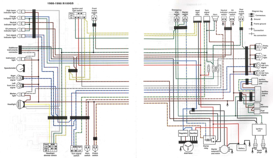

This might help, it's for a 88-'90 r100gs.
Should be close enough (maybe identical?) to a RT to resolve most issues.
It's a jpeg, so it gets blurry when you zoom in.
I can email you a PDF format so you can zoom in all you want and it stays clear if you send me your email address.
Not sure how to post a PDF here.

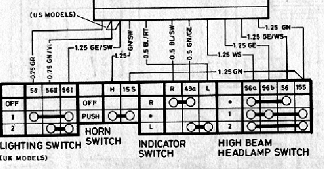

The second one shows the U.S. vs. euro headlight wiring by-pass.
By the mid '70's, North American motorcyclists were not deemed intelligent enough to determine when their lights should be 'ON'.
By the mid '80's, Canada implemented a daytime 'headlight 'on' law for all vehicles so motorcycles could blend inconspicuously into the traffic flow even with their lights 'on'. Go figure.....

Thank you! Very useful and the definition is clear enough.gspd wrote: ↑Mon Jun 06, 2022 9:04 am This might help, it's for a 88-'90 r100gs.

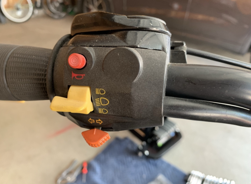

Then again my point: in all these diagrams the lighting switch seems separate from the key-ignition switch, like if it was a specific switch/control on the handlebar. Which I don’t have.
On my handlebar I only have high-beams (on/off, not even flashing): do you guys have the same on your bikes? (See pic here)
Or maybe it’s just me who cannot read those diagrams..

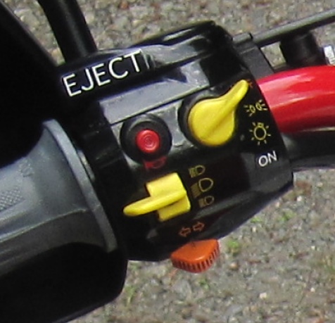

This is the 'EURO' switch with the headlight function.
Available from BMW.
NOT 'plug'n'play.
You have to switch a few wires around.
Note to Mel: EJECT function keeps passengers 'quiet' and on their best behaviour.
Available from BMW.
NOT 'plug'n'play.

I like the EJECT function! Lol
It’s an aftermarket switch.. which probably matches the wiring diagram more than the actual original production control!
