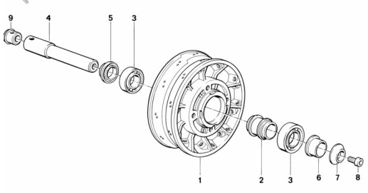

Point to ponder
Replacing the 'stack' with sealed bearings would be ideal.
My front wheel has them, as do all modern bikes.
Maintenance-free and they virtually last forever.
I'm not sure what's readily available and exactly what that job would entail.

Re: Point to ponder
gspd wrote: Thu Jun 16, 2022 6:17 am Replacing the 'stack' with sealed bearings would be ideal.
Relevant sized deep groove ball bearings are made (that is to say the same nominal sizes as the taper bearings used by BMW i.e.40 x 17 x 14) however they don't seem to be commonly available and all of the listed suppliers seem to come from Russia. If they could be sourced, I would think the only other thing you'd have to do would be to adjust the spacer and wedding band so that they run central in the groove.
As a matter of interest, the R65LS does use a 40x17x12 ball bearing on it's from wheel.
I do wonder what their life would be though, they are substantially smaller that the 47x25x12 bearing fitted to your bike and the Mono range... and they certainly don't last forever.

20th century(ish) vs. 21st century(ish) technology
Rob Frankham wrote: Thu Jun 16, 2022 4:36 pm .... deep groove ball bearings ..... don't last forever.
I agree +1
Nothing lasts forever. And size matters.
However I said "virtually forever".
540,000 maintenance free kms and counting on mine.
If they didn't spin as smoothly as when they were brand new or if they exhibited even the slightest play, you know me, I'd have replaced them by now. ;)
"I intend to live forever, or die trying". -Groucho Marx
