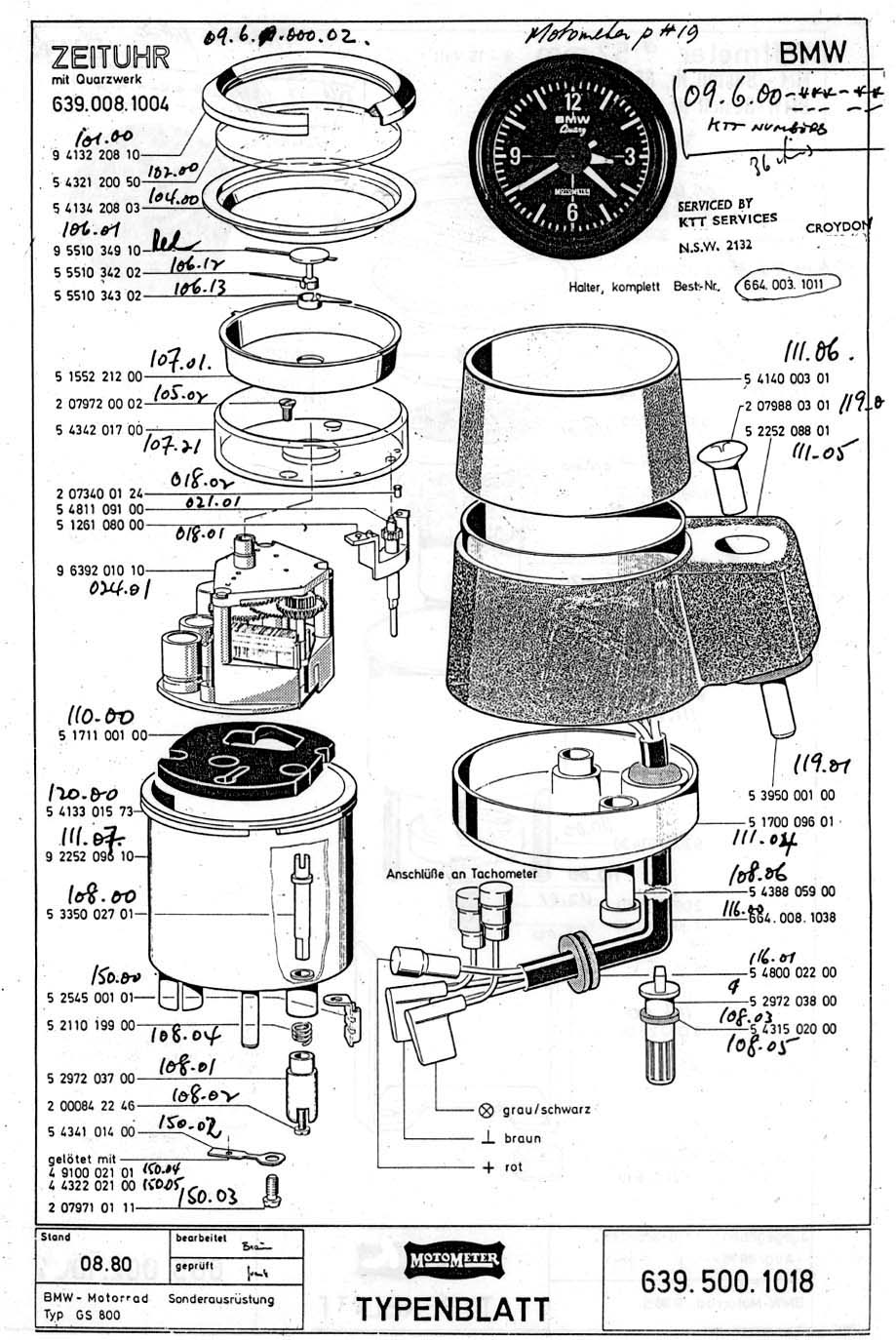

Reportedly the capacitors fail. I believe it's a relative simple job replacing these.
Tantalum 16V 100uf capacitor
The removal and reinstallation of the black bezel that holds the glass might not be so easy...but there is a way.
