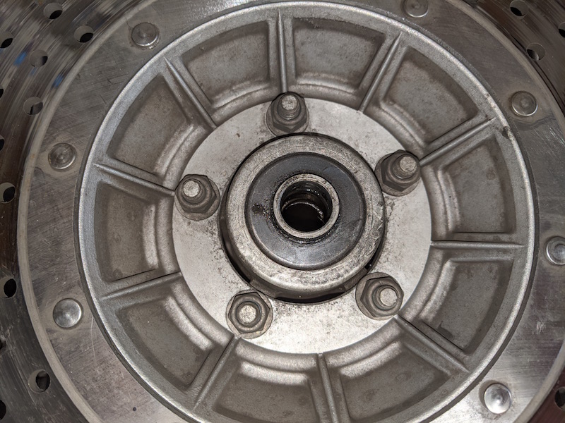

Re: Front wheel bearings
Where is the retaining nut?gspd wrote: ↑Sun Jul 17, 2022 6:40 pmOnce the retaining nut, the seal and the tophat spacer are removed, the tapered bearing should fall out.Zombie Master wrote: ↑Sun Jul 17, 2022 2:20 pm There are some confusing cautions in my book, telling me not to remove the bearings unless I am replacing them.
The outer bearing ring will remain in the wheel.
There is no reason to remove it unless it needs to be replaced.
Clean the bearing with a toothbrush in a bowl of gas then gently blow it dry with compressed air and repack it with fresh grease. Resist the urge to put it on your finger and spin it dry with compressed air as this can cause the rollers to come out of their cage.
- PXL_20220718_015905018.jpg (220.75 KiB) Viewed 1551 times
ooops! my error.
Snowflake wheels don't have that retaining nut.
- Zombie Master
- Posts: 8828
Origin seals? I can't remember if you said.
You'll need to booger them to get the top hat and bearing out. The rubber ones can let the top hat out but it's not ideal.
How do they feel an the axle? Remember these bearings are supposed to do umpteen billions of miles.
You might be a billion off needing maintenance.
The metal body seal looks like a good candidate for a drilled hole and self tapping screw, to pry out?

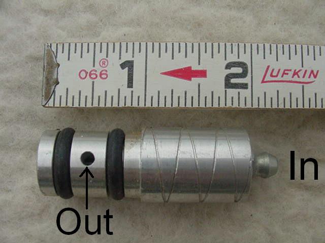

There is a greasing tool available that allows you to add grease to the wheel bearings on all pre '85 airheads (well almost all... not the R65LS front which is a ball bearing but all models that use the taper roller bearngs). There are various variations but essentially it consists a metal plug with two 'O' rings and a grease nipple (zerk fitting on this forum I guess) at one end. There is a drilling from the fitting that emerges between the two 'O' rings. With the wheel out, simply push the tool into the axle hole and pump grease in. The 'O' rings stop it escaping directly into the hub and it is forced into the bearing itself pushing old grease out. No need to disturb bearings or grease seals.
The only downside is that the used grease tends to accumulate in the hub so you have a bit of a messy job when you do next remove the bearings.
All in all, I wouldn't recommend it's use on dirt bikes where there is a really good chance of grit getting past the grease seals but, on a road bike, used regularly, it works very well and saves a lot of bother removing seals and bearings every time you want to grease them.
- Posts: 1721
^^^ The above is from Duane Ausherman's website.
