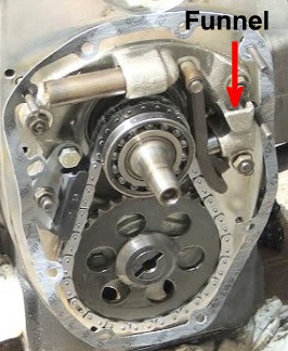

FYI - piston and spring replacement.
The piston and spring should be replaced as a preventative measure but never seem to actually wear out or fail.
The spring's purpose is obvious: it applies a pre-determined degree of tension to the chain to prevent it from slapping around.
The piston is actually a hydraulic damper, something that never seems to be mentioned, and therefore ignored. It gets filled with oil that gets splashed into a funnel just above it via a tiny hole while the engine is running. Once full, semi hydraulic lock prevents the tensioner from being pushed back by chain fluctuations.
It's the same principle that's used for hydraulic lifters on automotive valvetrains.
Be sure the feed hole at the bottom of the funnel is not blocked with debris and if you want to be really fussy, you can prime this funnel with oil before re-assembly.
Also, a final tip (that many won't agree with): Just use grease on the gasket, not sealer.
And again, don't forget the two top washer gaskets (common omission).
- funnel.jpeg (48.28 KiB) Viewed 1394 times
