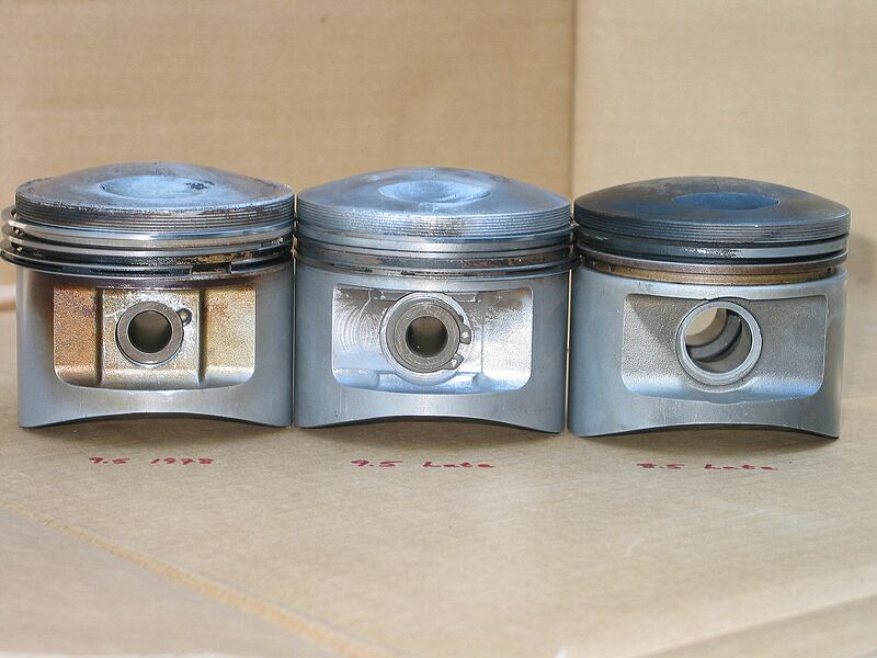

I have the same bike (a CFO version) and am considering a top end rebuild before selling it. Haven’t yet taken the heads off but it is my understanding is that year had different pistons and heads, with a piston dome that does not extend out to the edge. (see the piston on the left below)
From
https://bmwmotorcycletech.info/pistons.htm
8. High compression pistons may have problems with the head. Later pistons had the dome extending to the edge; later 1970's types with the squish band were designed to work with a matching cylinder head, & might have to be machined. This might occur with some modification you are attempting, such as later pistons fitting 1977 heads. The squish pistons used on such as the 1977 R100RS are hard to find and were used only in that year and model. The original 'squish' pistons are no longer available. If you have a 1977 R100 & need pistons, you could consider using the 9.5:1 1978 pistons with the outside circlip. One can modify the head & cylinder (deck height change, about 0.050") and thereby get your own squish pistons in practical use. The 1978+ had a different shape for the pistons ...at the edge as an example. Perhaps some pre-emissions 1978 pistons will work, but you would have to order them & look at them.
From

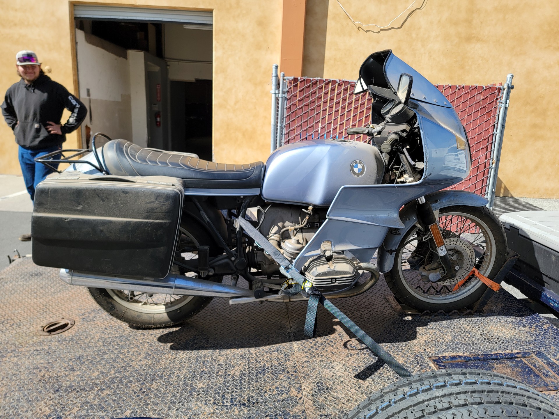

Been a bit of a delay in getting the bike ready for transport, a few individual schedules that needed to be aligned but we have broken through the hurdles and she is packed and ready to begin an escorted trip from California to Massachusetts. Many thanks to her foster parent, Suede in Hollister, California for 15-years of babysitting. As well, many thanks to Victor and the crew at Hollister Motorsports for prepping her for her long journey home.
Presently, I'm awaiting the final shipping company to provide a schedule. That being said, I had gotten earlier quotes for cross-country transports that were well below $400, however things have changed. Estimating the same sources, prices had tripled, but: Shout out to Steve Allen @ BevelHeaven, www.bevelheaven.com who has provided an insured, enclosed and dedicated transport for a reasonable price. Steve has been providing Ducati spare in California for years and remains my go-to guy for the occasional "one-time-only" question such as shipping. Check his website for transport costs, there's a simple form to complete and your cost is quickly displayed.
I'll address the individual replies once the bike arrives, I've chosen my engine mechanic and cosmetic provider. We will have lively discussions on recommended alterations.
