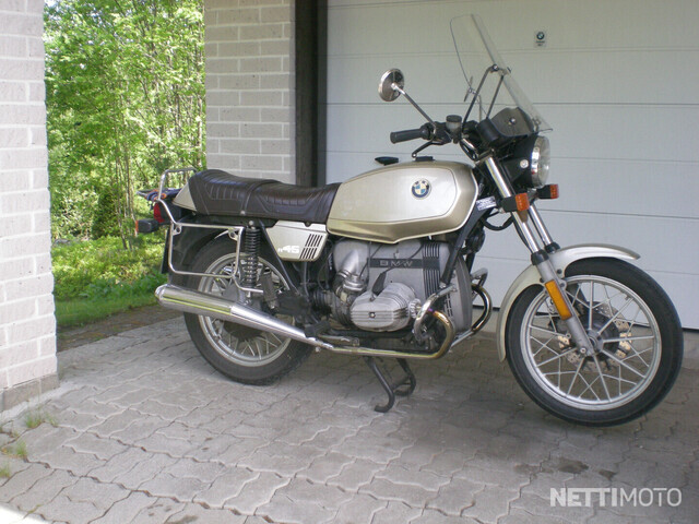

Sounds like it might be a sleeper. ;) Has it still got R45 decals?

SteveD wrote: Sat Dec 31, 2022 5:34 am Sounds like it might be a sleeper. ;) Has it still got R45 decals?
Yes. See attached photo.
