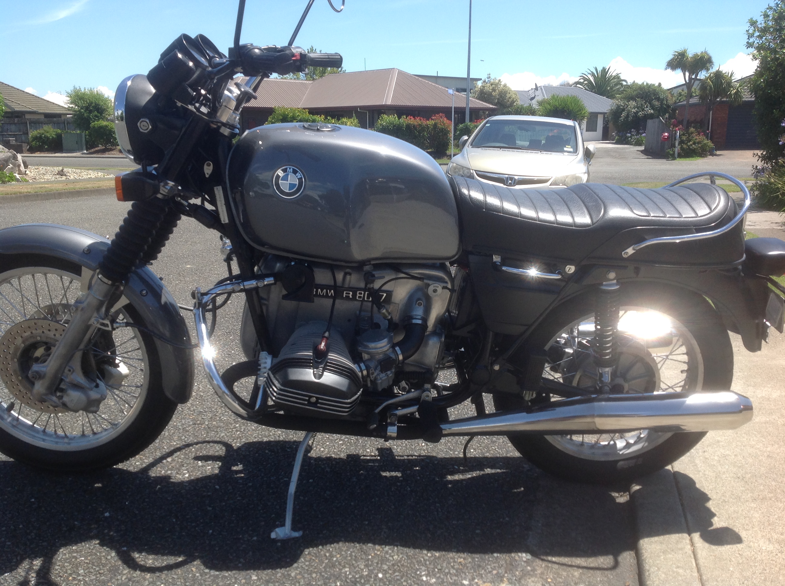

Well after almost 2 years I have finally got the R80 back on the road, it has been a pleasant and at time frustrating adventure but the results have been worth it, am surprised by a few things first the brakes in that these are not as bad as I had feared, they are the ATE with the under tank master cylinder and everything was refurbished by me and new seals and pads, I paid attention to the correct set up of the twin calipers and spent extra on top of the line pads and it's all come good.
The motor is very pleasant and above 3000rpm there is no vibration at all, am still running standard ignition advance even though I have been advised that the Boyer electronic ignition should be full advance at 4000rpm as I wanted to compare the results first.
On the down side and am asking for advise here is the suspension, rear shocks are stuffed and am thinking Hagon as replacement's and am finding the front quits harsh as well, these still have the standard springs an am told progressive items are the way to go, here in NZ the speed limit is 100kph (62 MPH) max and is being enforced quite hard depending on where you live and our roads are quite bumpy.
So is the bike a disappointment? no not at all as it puts a smile on my face and compared to my other bike (F800 GS) is amazingly easy to work on and easier to get on and off as well, the GS is a bit top heavy for my liking so I think I will sell it.
See attached photo of the results of my efforts.

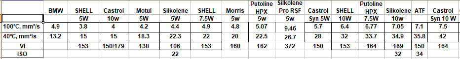

The original BMW fork oil was extremely thin. The nearest I was able to actually buy was the Motul 5W Here's how it compares with some other fork oils It's best to make comparisons at 40 Deg C which is nearer the actual operating temperature of the oil.
Fork oils.PNG (12.75 KiB) Viewed 2066 times
