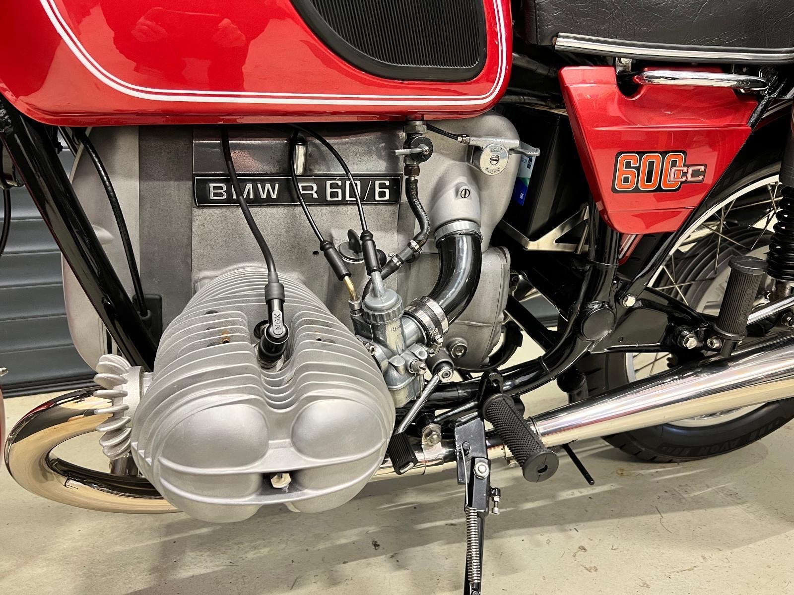

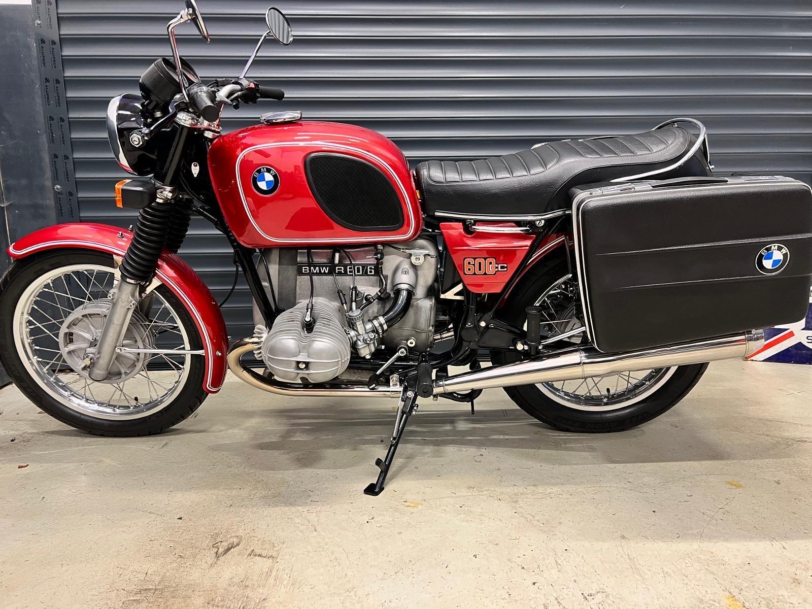

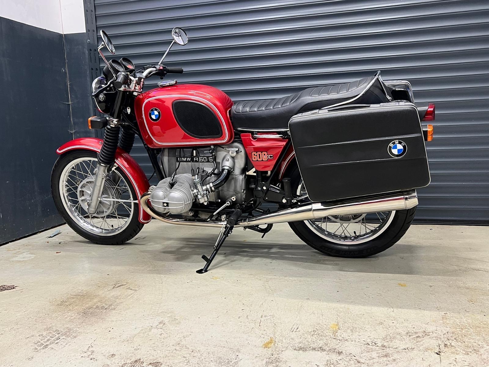

Roy sent me a few photos so here they are. Doesn't it look fabulous.
- C39A2128-F734-4B05-B5E4-AF56ADAA9078.jpeg (529.97 KiB) Viewed 2427 times
- 72FF1CE7-7D62-4510-99D3-87DC5674593C.jpeg (502.59 KiB) Viewed 2427 times
- 005D14EB-8ED1-499C-BD53-7AB3E181860D.jpeg (507.14 KiB) Viewed 2427 times
