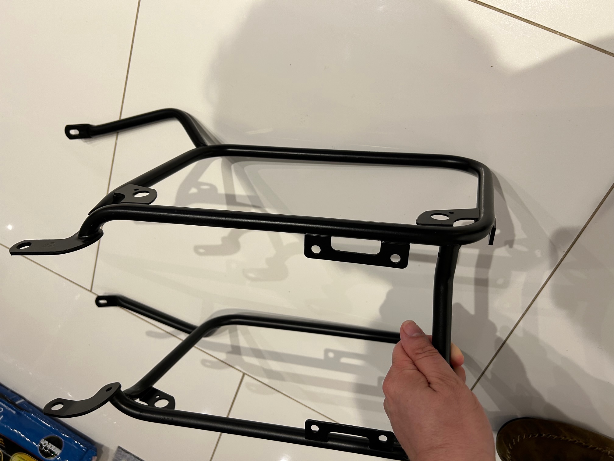

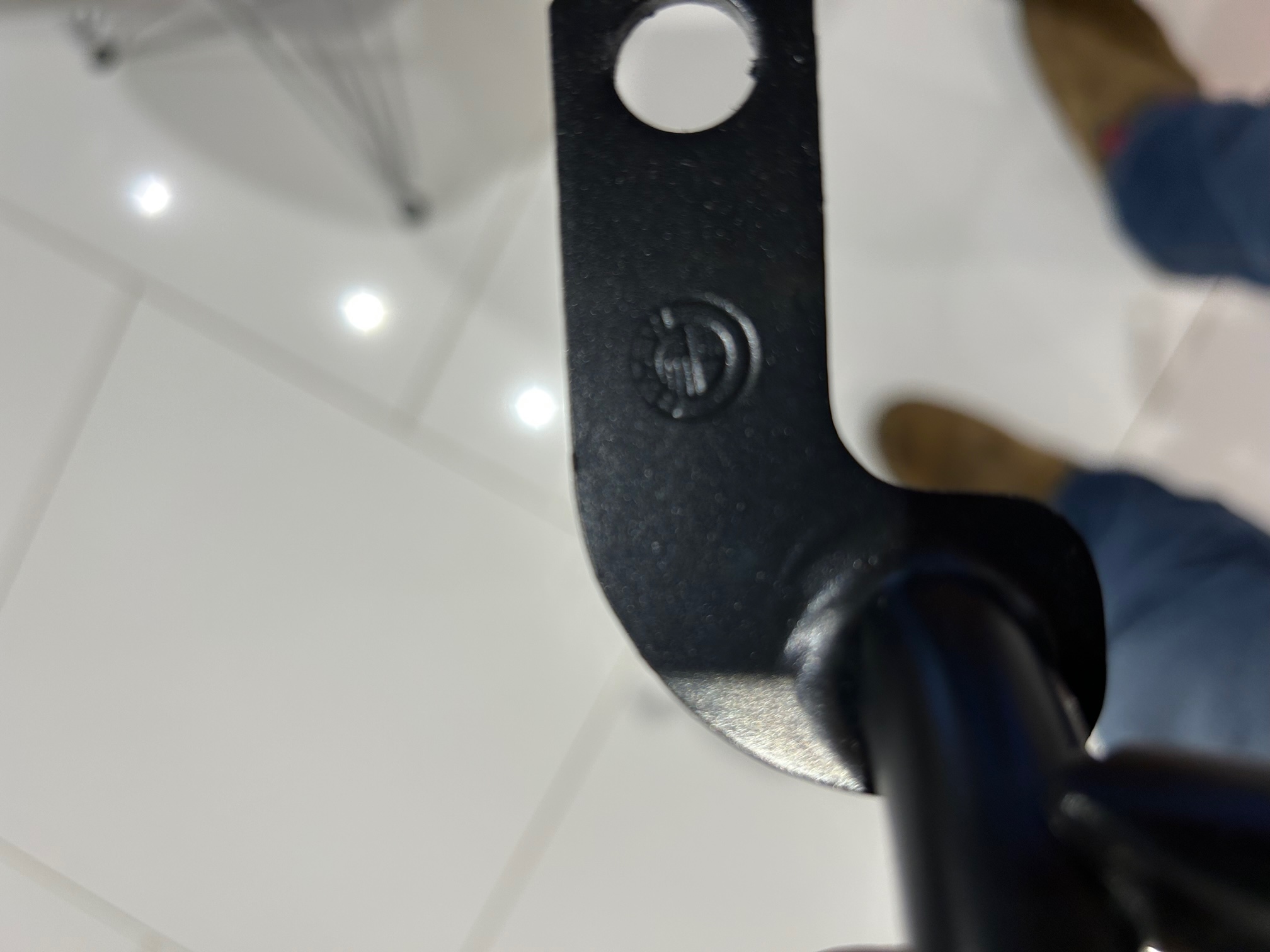

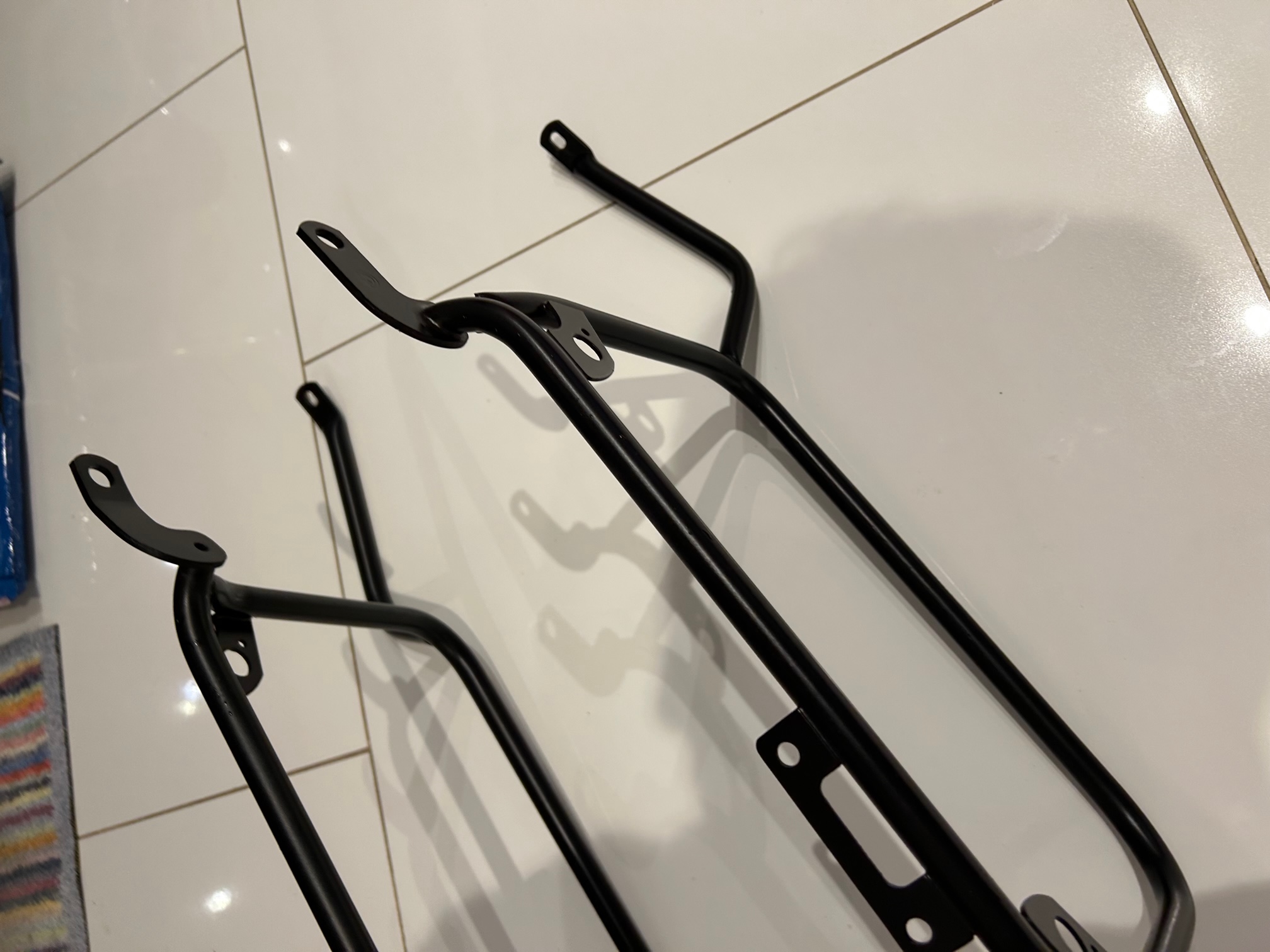

Hello i have a mystery saddlebag rack, i bought it for my BMW R75/6, but it does not fit, i have since found out i have a LWB model from mid 73, but i dont think it would fit any R75/6. I bought BMW Saddlebags complete with rack.
i would like to sell the rack on as I have had it fixed (it was cracked so needed a weald) and powdercaoted. Yes i know i shoudl have double checked i had the correct one before going to the trouble, however i have no idea which BMW it of from. its a BMW rack as it is stampled with teh BMW logo and came with some original saddlebags. can anybody recognise it, please note the orientation of the bottom bracket, the hole is for a virticle bolt rather than the usual horazontal

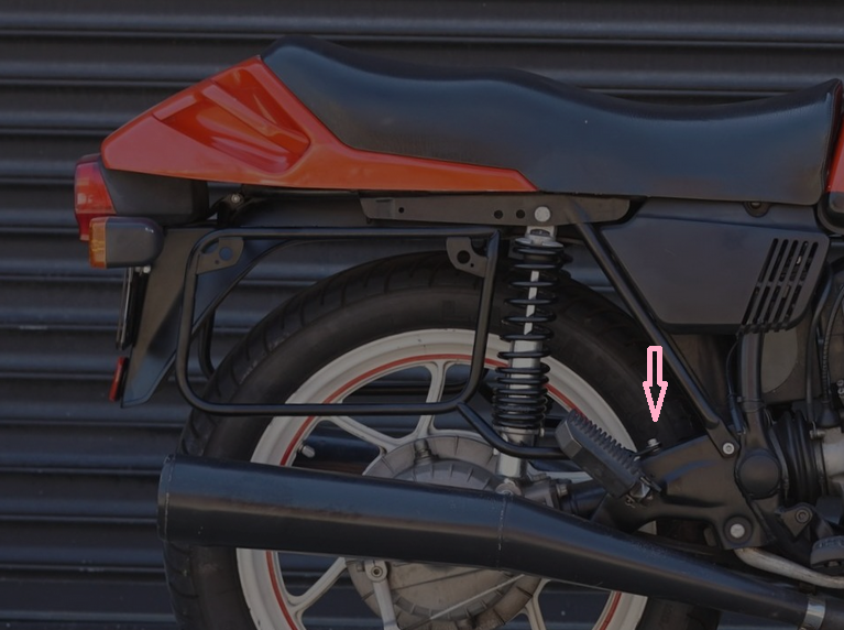

I'm guessing R65? See where it attaches...

thanks Steve, thats spot on, brilliant - after seeing the cost of a replacement rack, i did think about making a bracket to bridge between the rack adn the bike frame, but i will see, its a massive help knowing how to list these like new brackets for the correct bike

Is that a single piece rack or are you holding two single sided racks together for the images?
damienbove
Posts: 30
Joined: Mon Mar 27, 2023 3:06 pm
Re: Mystery Saddlebag Rack
Post by damienbove »
its two sepreate sides held together
damienbove wrote: Fri Mar 31, 2023 5:55 am its two sepreate sides held together
Ah... in that case. I think (as has already been said) that it's the type of case that was supplied for R45 and R65 machines. It will also fit very early short wheelbase /5 models.
On the longer wheelbase models, the lower struts bolt to the outside of the exhaust hangers while the R65/R45 version bolts to the top.
The racks supplied for Mono machines also attach at the top but the struts are a different shape and are not mirror image due to there being no need to avoid a left hand shock.
It might be possible to adapt these to fit your machine but it would probably be easier to source a pair of the correct racks. They aren't hard to find. It's a shame really, the ones you have look to be in really nice condition... perhaps you can get something back for them.
