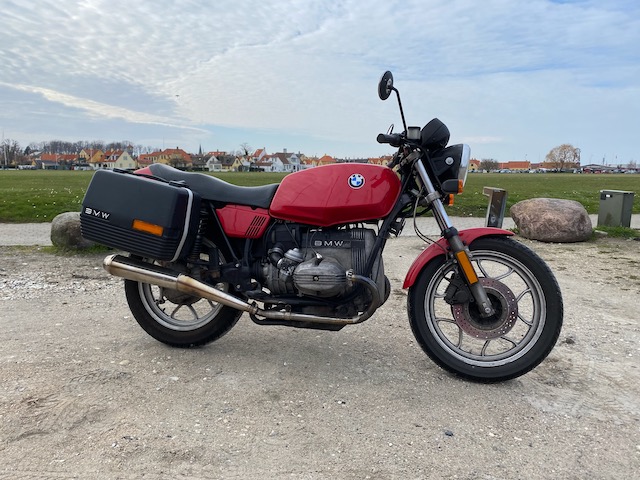

Hi,
This is my first post in this forum :)
I have an R65 from 1981, which I had for 1.5 year now. It's really great, but the issue is that it's not comfortable to bring my girlfriend as a passenger. The biggest issue is that our feet are too close together, so either I have to bring my feet forward against the break/gear shifter or she has to move her feet backwards, which makes them lean on the exhaust pipe.
Did anyone have the same issue? Is there a kit to move the footpegs or any ideas on how to customize them? And potentially lift the seat as well.
Btw, I'm in Denmark, so it's a European bike.
IMG_1338 (1).jpeg (117.22 KiB) Viewed 1797 times

Was it originally a R65LS?... the wheels appear to be the ones used on an LS... the ordinary R65 uses 'snowflakes'.
Re: Passenger footpegs on R65
Yes they do look to be LS wheels. I prefer them to snowflakes. I'm sure they were a fair bit lighter too. Nothing else on the bike looks LS though unless the tail piece has the LS integrated grab handles which is hard to see with the panniers in the way. The little fairing around the instruments isn't there but I guess they are as rare as hens teeth by now. The front fender is not original, neither stock R65 or LS.

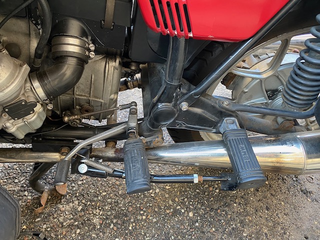

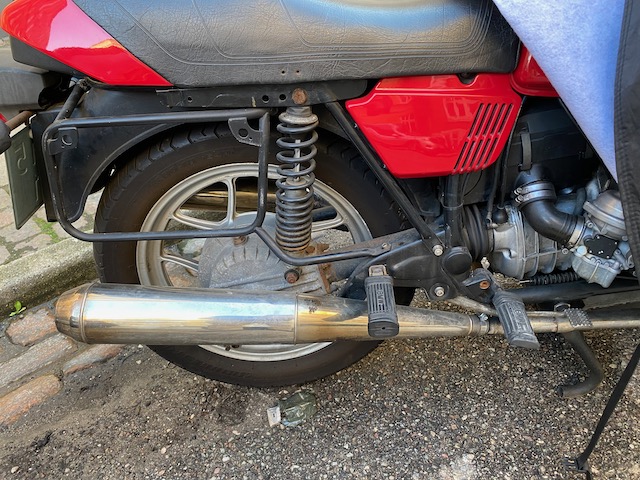

Thank you for all the responses. I took some photos up close. The passenger's footpegs are not moveable. My own may be adjustable, but I don't think it will give me much.
I have measured the inner distance to 16 cm on the left side and 19 cm on the right side. Is that smaller or similar to what you guys have?
I measured the center-to-center distance on my /7. My rear pegs have some adjustability to them, but are currently as far forward as they can get. My left side is 24.7 cm while my right side is 19.1 cm. Interesting my left side is the biggest...different than your measurements.
