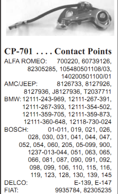

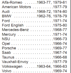

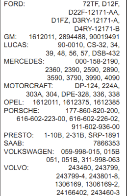

It's a shame such a simple component as points are hard to obtain in decent quality. I still have a spare new set of BMW supplied points that must be well excess of 15 years old which I think is before the Chinese shenanigans. With the aid of an pointers booster, they should outlast me.
For those with points in a can there are allegedly many alternatives available which is perhaps not so surprising given the can was developed from an existing automotive distributor. Here is what is supposed to fit.
Bean Can Points.png (85.7 KiB) Viewed 1350 times
Bean Can Points2.png (85.64 KiB) Viewed 1351 times
Bean Can Points3.png (62.2 KiB) Viewed 1351 times
