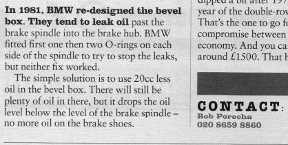

I would be inclined to remove the brake arm and measure the shaft diameter as a clue to the correct O ring size. Even then will you know how many O rings are fitted until the shaft is removed ?
Brake cam.png (71.88 KiB) Viewed 4484 times
