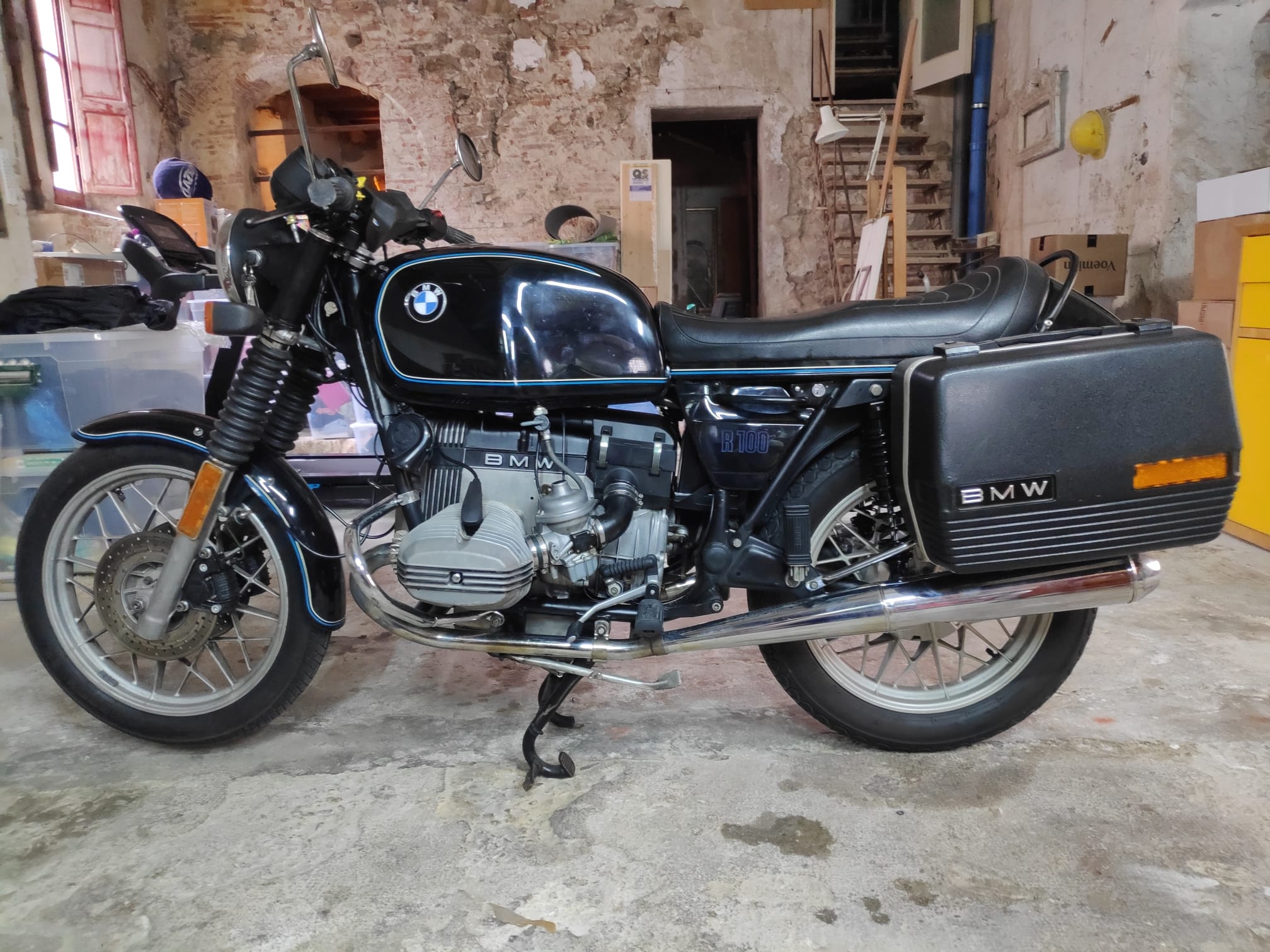

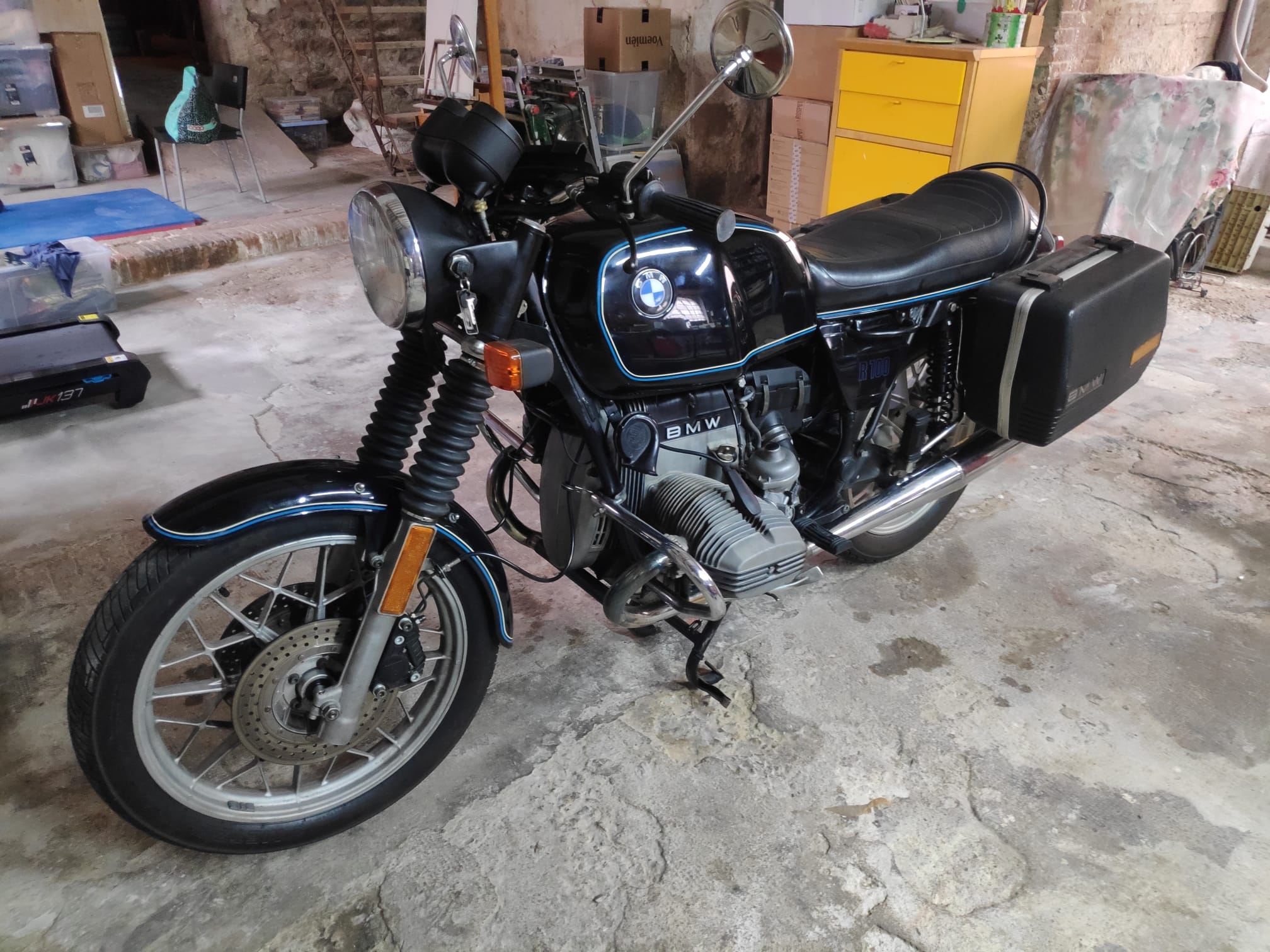

I started restoring this bike on the past November, now is finished after a lot of painted, changed, repaired, cleaned parts.

new improved brake lines
new front brake pump (old one was dead)

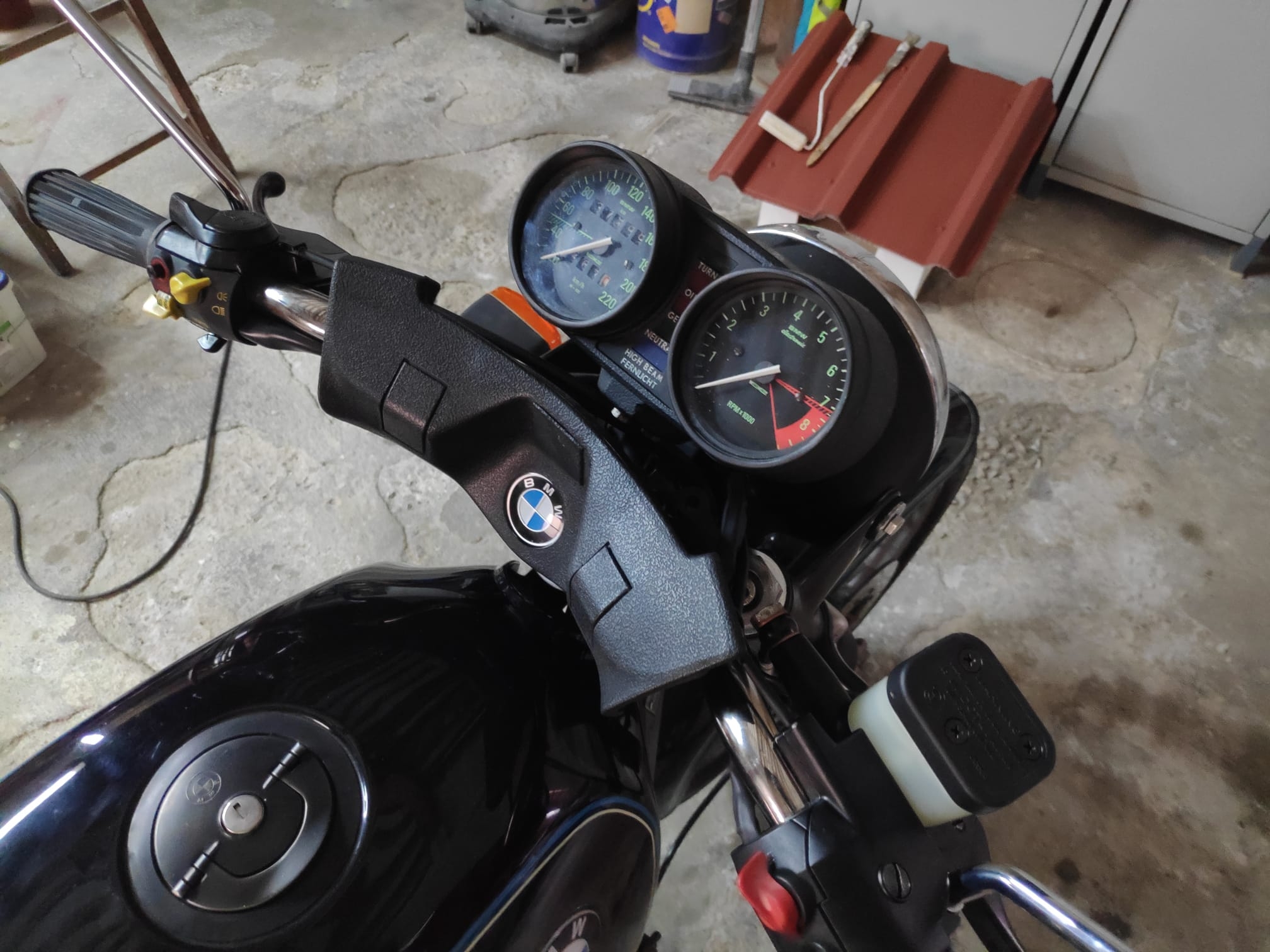

new front lamp
new lamps inside the dashboard
tommaselli wider handlebar
new steering bearing an lower yoke
polished chromed parts
restored tank (repainted the part touching seat)
new rear brake pads
new throttle cables and choke
new clutch cable
cleaned carbs
completely checked and repaired electrical harnesses
I'm going to service the engine and transmission with new oils and after the Italian summer I planned to change
also Oli pan gasket and valve rods grommets
