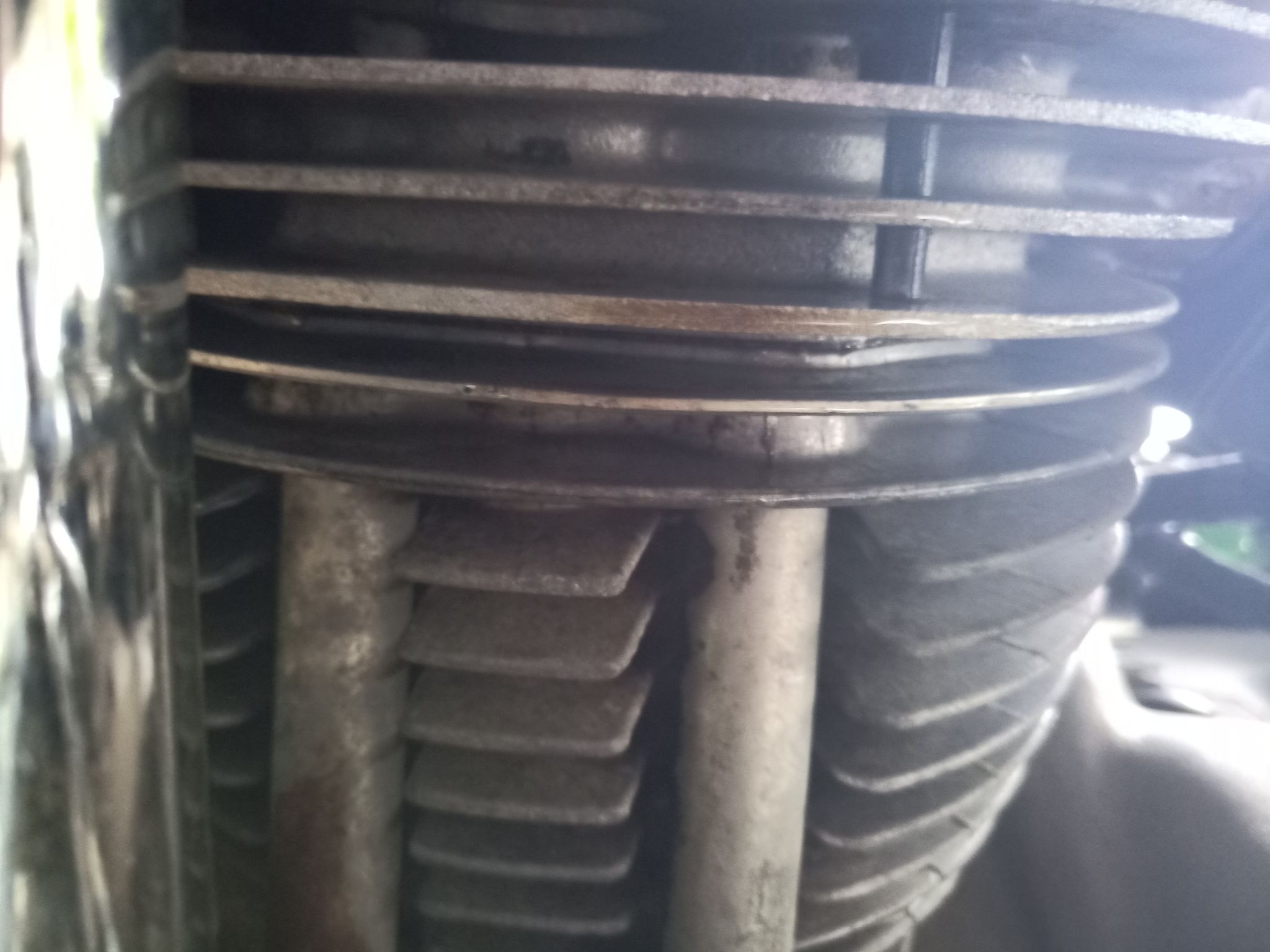

Here's what I'm looking at. Left cylinder from below.
Left side cylinder R60_5.jpg (218.17 KiB) Viewed 2047 times
Re: Oil Leak at head gasket
Difficult to say but it does look like the head gasket. Not a massive job to replace...

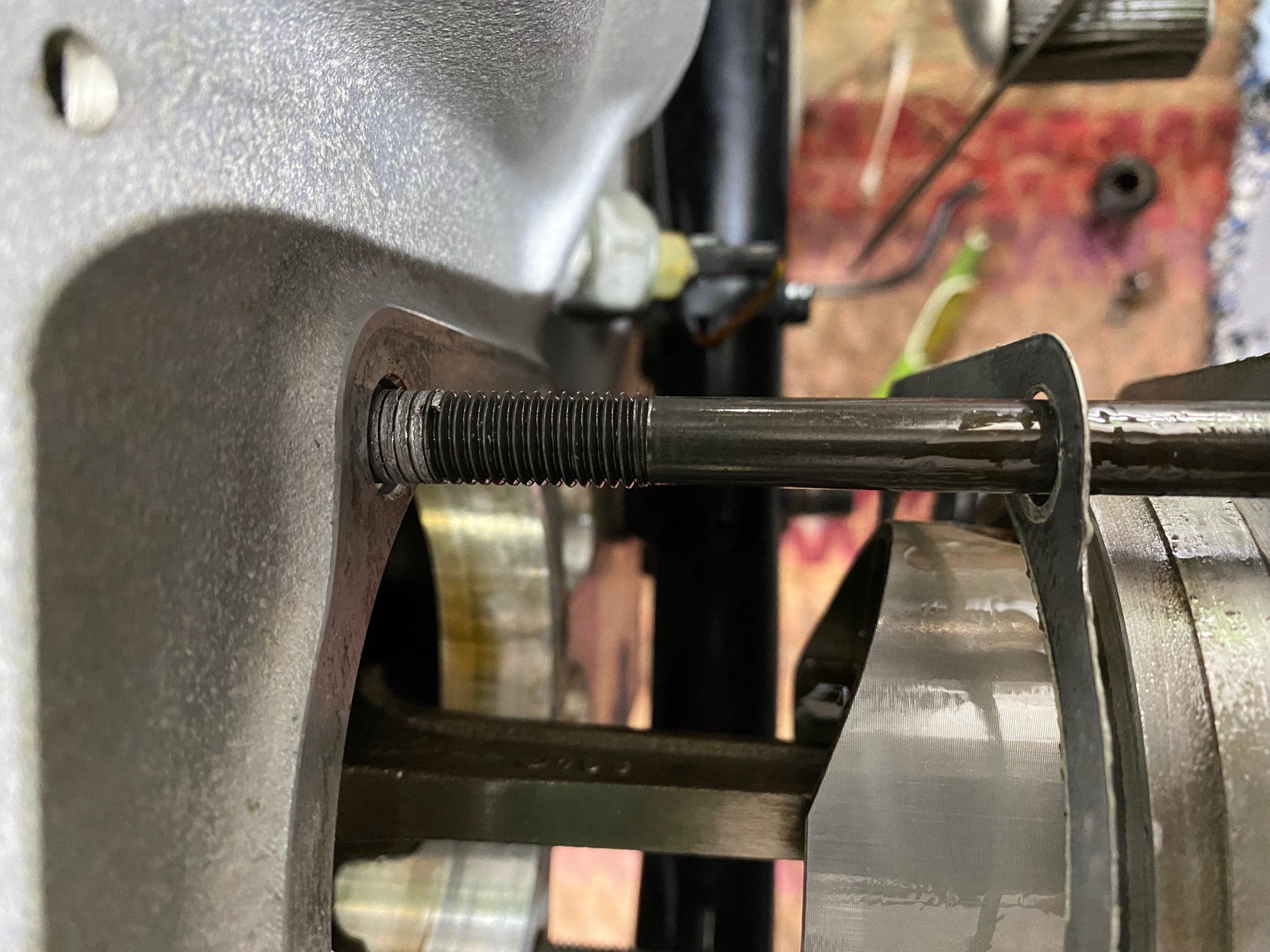

Further along this issue, I found a damaged head bolt stud. (left cylinder, upper intake). Would anyone know where I could obtain the jig/tool that is used to assure the hole is drilled and tapped accurately for repair?
Head Stud Failure.jpg (713.21 KiB) Viewed 1911 times
That's a helicoil or insert job complicated by the need to ensure that the oil hole mentioned in my earlier post is kept clear. Probably a job for a machine shop.
