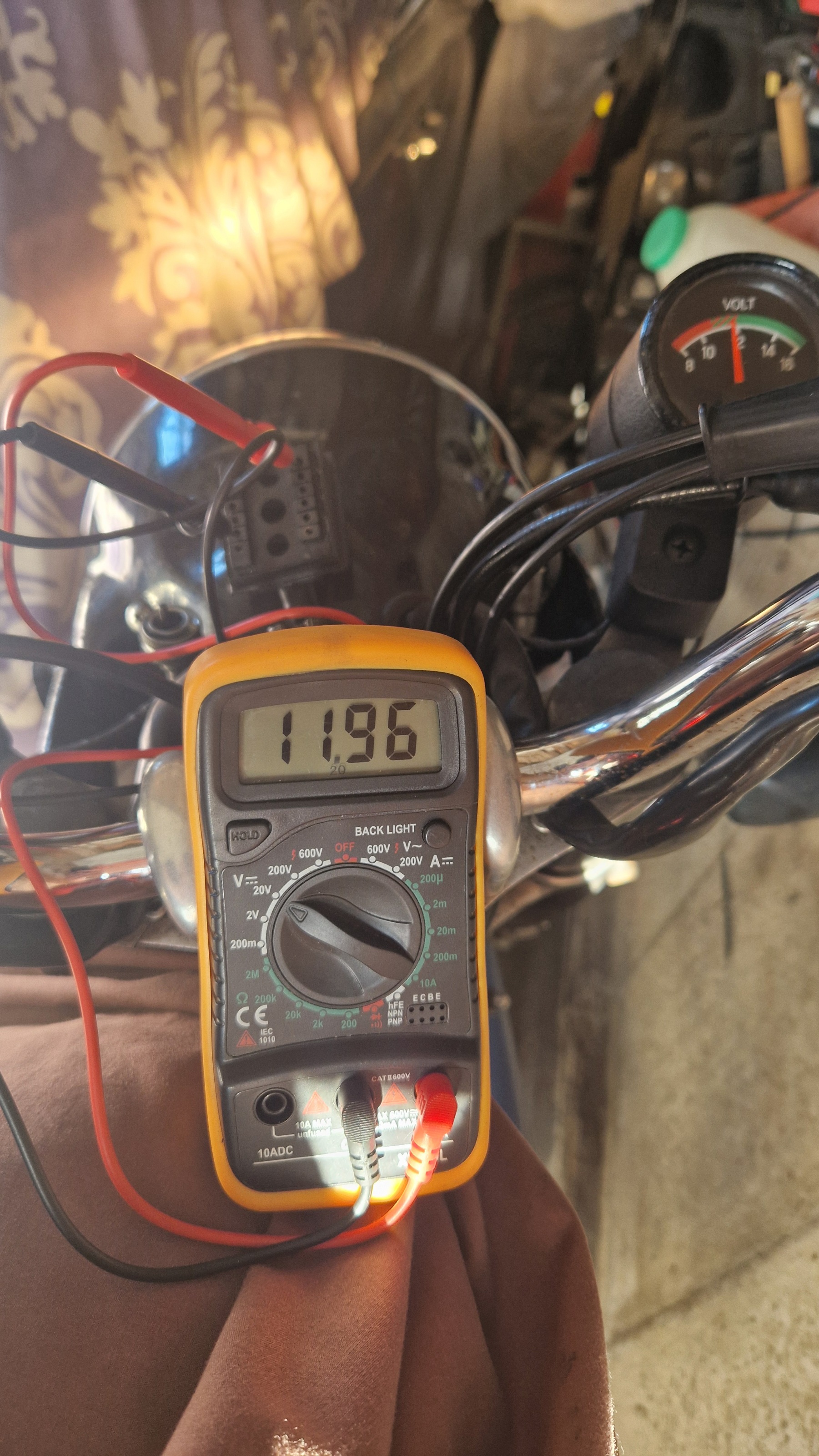

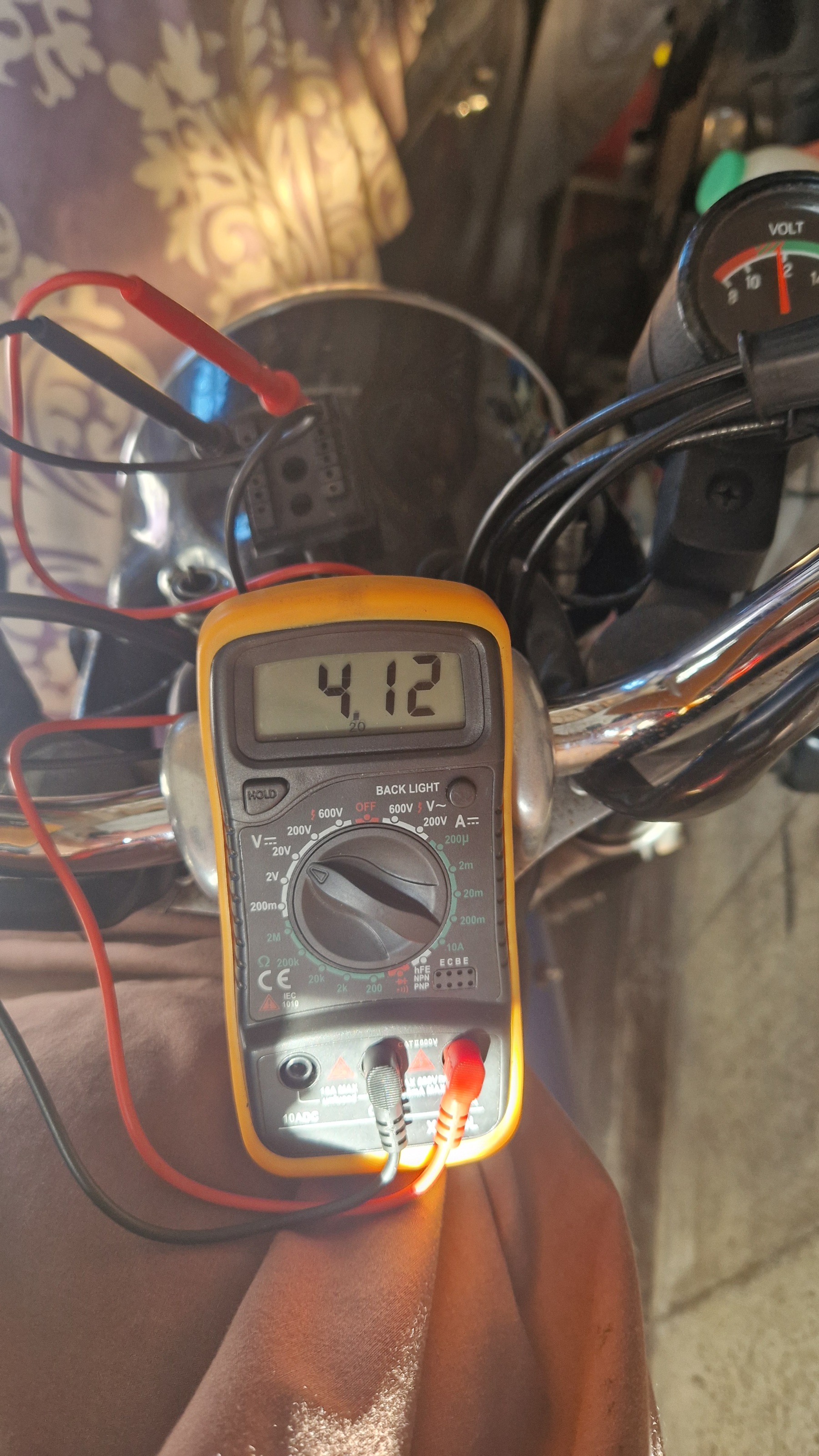

Pics of your voltmeter probes on the exact points where you are reading 12v and 4.5v might help clarify things.

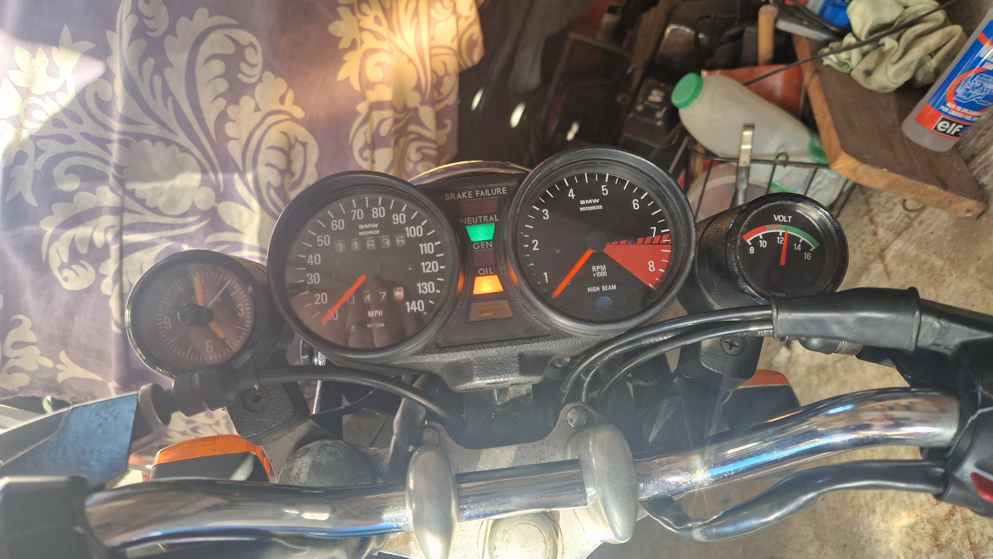

I've followed the circuits in the dash from the warning light bulbs and taking the readings in the appropriate holes on the large.connecting plug.
Readings are taken with ignition on, engine not running. The previous owner disabled the light switch (on all the time) which may be relevant to the readings i'm getting.
I've attached a few images showing:
Dash with ignition on (no charge light)
Test showing 11.96v (oil light terminals)
Test showing 4.12v (charge oight terminals)
