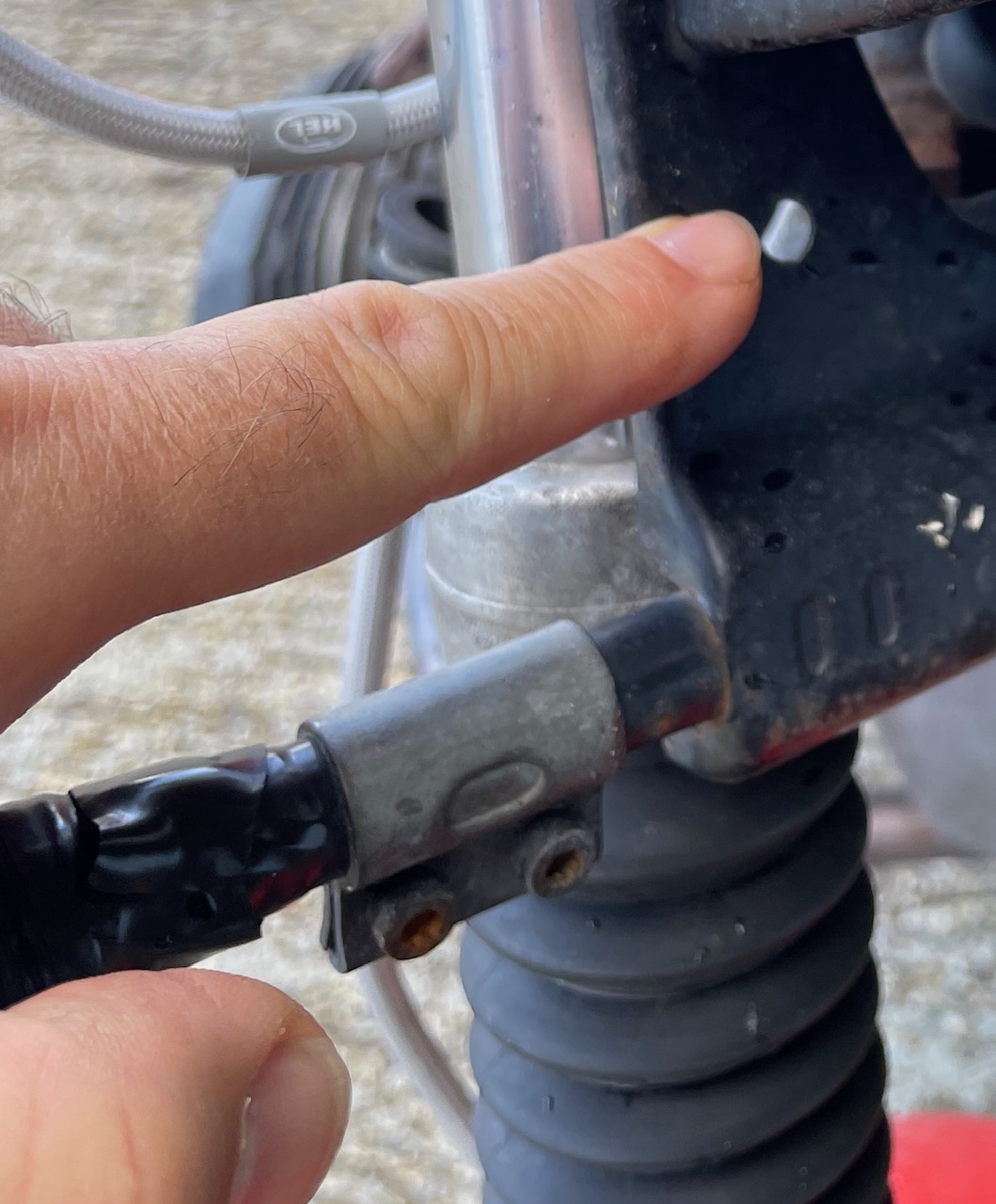

Here is a photo. It’s not where my finger is pointing but it’s the collar that has two Allen bolts in it directly below my finger joint in the photo. I need 2 of them.
Thanks !

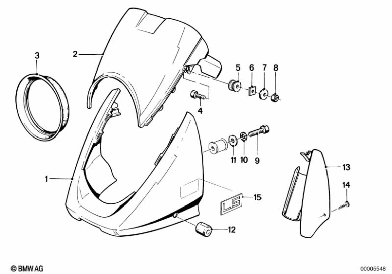

Part search is for # 13 & 14?
https://shop.maxbmw.com/fiche/DiagramsM ... d=09082020

No it’s not #13 and 14 that’s the cover that goes over the fork legs and the screw that holds it in. I’ve stuck a photo on my orig post and it’s the collar that’s UNDERNEATH where my finger is pointing.
