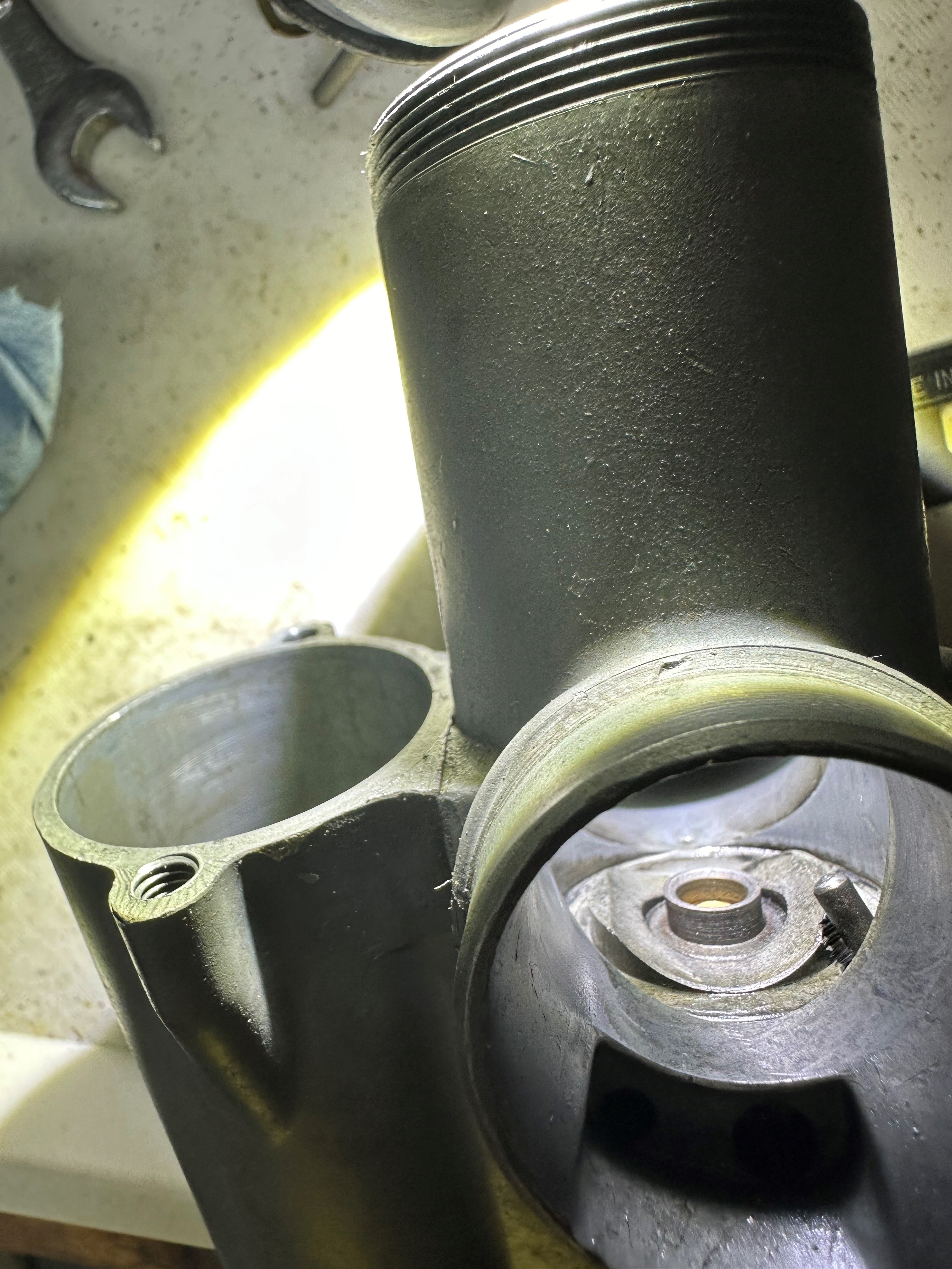

I'll keep this in mind and if other things don't work, I'll give it a shot, but the fuel level is so low that I can't imagine it would create enough vacuum to do this. Especially considering it was coming back on song so quickly when I got back to level. Also, I had a look at the slide needle guide and I don't think it is sticking up at all. I found Ausherman's site that you refereneced, but the pic links are dead so I didn't have anything to compare to, but I don't see any splines on Frank's (pic attached). The other side looked the same.

If the slide guide sits too tall, your slide won't be able to hit the bottom...you'll have trouble balancing the carbs.
You may have to find Ausherman's site on the Wayback Machine.
