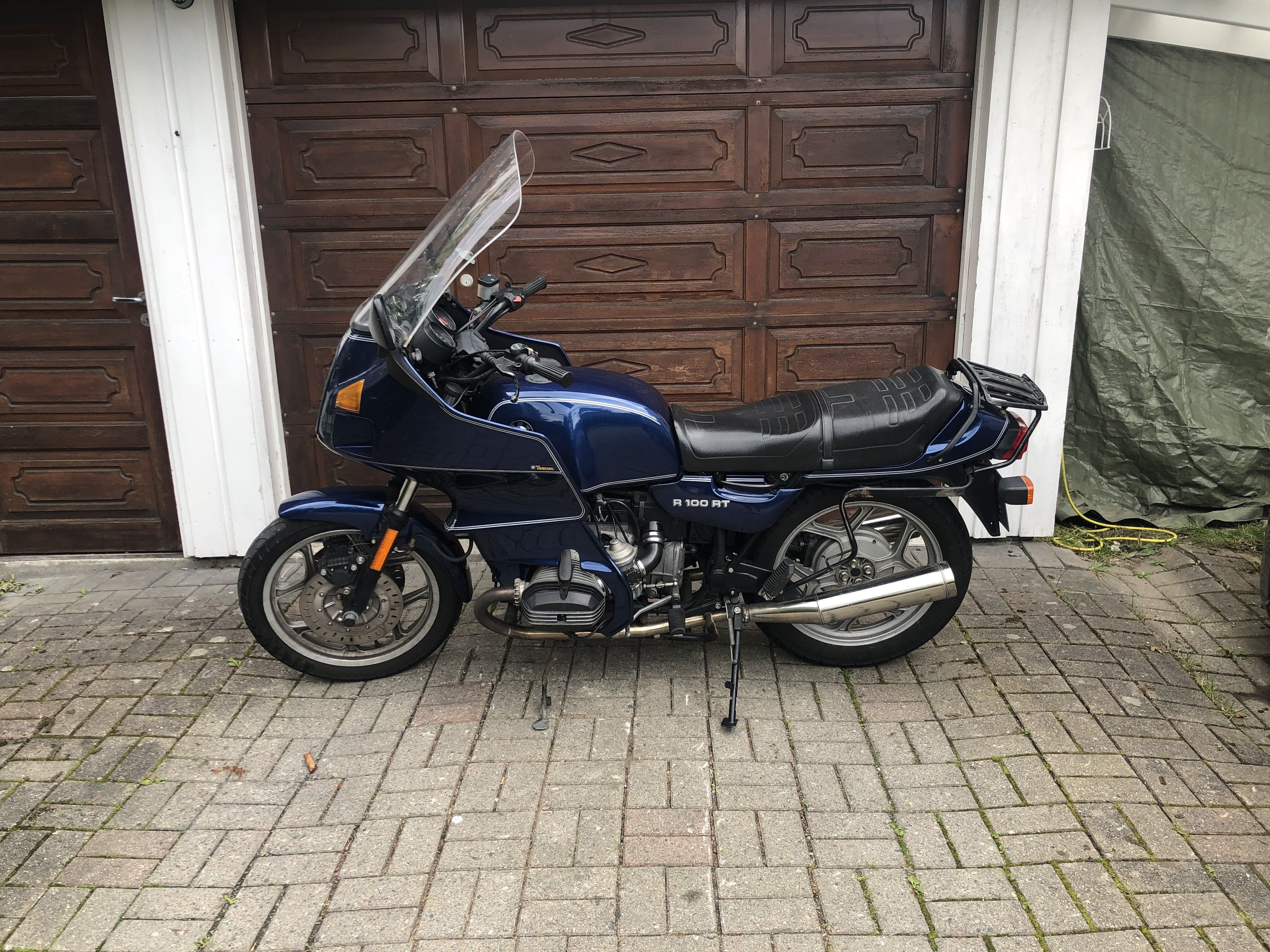

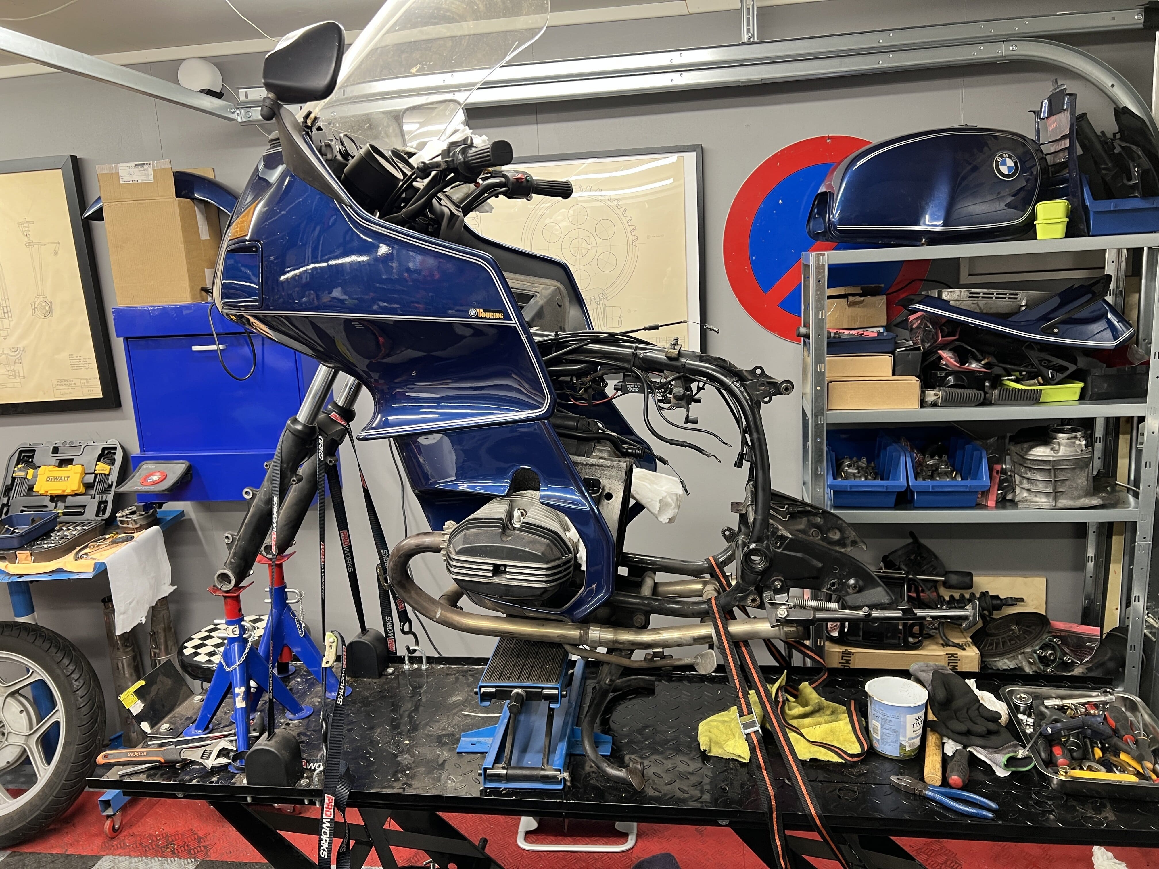

Before and now :)
IMG_3923 (1).jpg (1.27 MiB) Viewed 33707 times
IMG_8070 (1).jpg (1.77 MiB) Viewed 33707 times

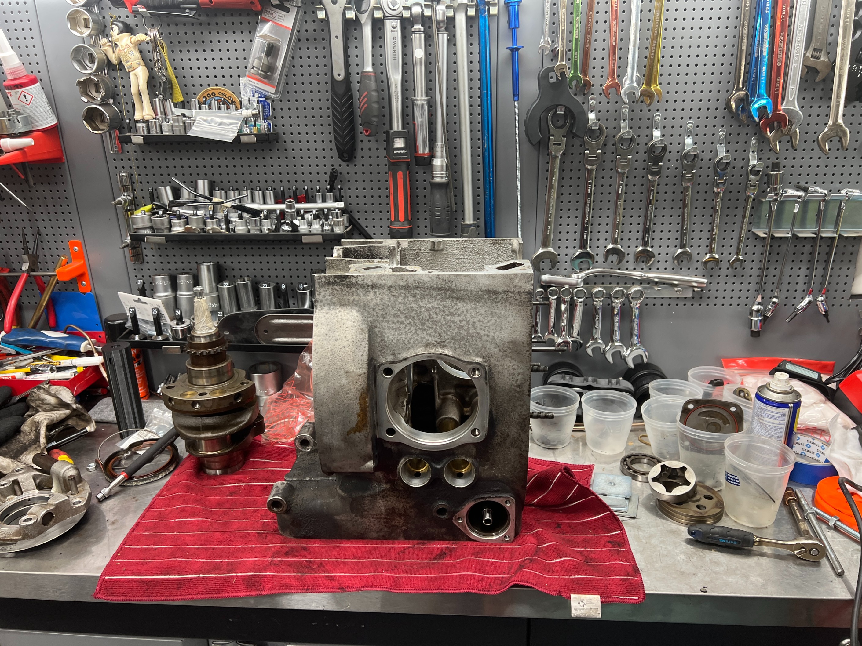

It looks like I went a bit further than I originally planned... 😊 Now, I will measure all the parts and check if any bearings or crankshaft thrust washers need to be replaced.
Overall, I think everything looks quite good.
I am trying to identify the crankshaft thrust washers by the numbers stamped on them. The color (if there ever was one) is no longer visible.
The inner crankshaft thrust washer is labeled 1256974,9, and the outer one is labeled 1256975,9. I don't understand what the ",9" represents.
It seems (based on BMW part numbers) that 1256974 corresponds to a blue thrust washer and 1256975 to a green one.
Anyone know?
IMG_4009 (1).jpg (1.43 MiB) Viewed 33378 times
Posts: 1338
Re: 1987 R100RT overhaul
Before even worrying about the size of your existing bearings, I would check to see if the end float of the crankshaft is out of spec. These bearings seldom give problems unless they are damaged by carelessness or lack of maintenance.
Assemble the crankshaft into the crankcase with the thrust washers in place. Fit the flywheel and use a dial gauge to measure end float. This should be between 0.08 and 0.15mm. If it is, reassemble the engine and forget it...
If it isn't, you need to check the thickness of the existing bearings. The sizes should be...
1 256 973 - red - 2.483 to 2.53 mm
1 256 974 - blue - 2.53 to 2.578 mm
1 256 975 - green - 2.578 to 2.626 mm
1 256 976 - yellow - 2.626 to 2.673 mm
Wear limit is 0.2 mm
Now you need to sit down with a piece of paper, calculator or computer depending on how old you are :D and use the exisitng end float, together with the actual thickness of the existing bearings to decide which combination of bearings will give you a float in the correct range.
It's not advisable to use an out of spec existing bearing, even if you can achieve the end float spec because the bearing surface will possibly fail.
Hope that helps...
