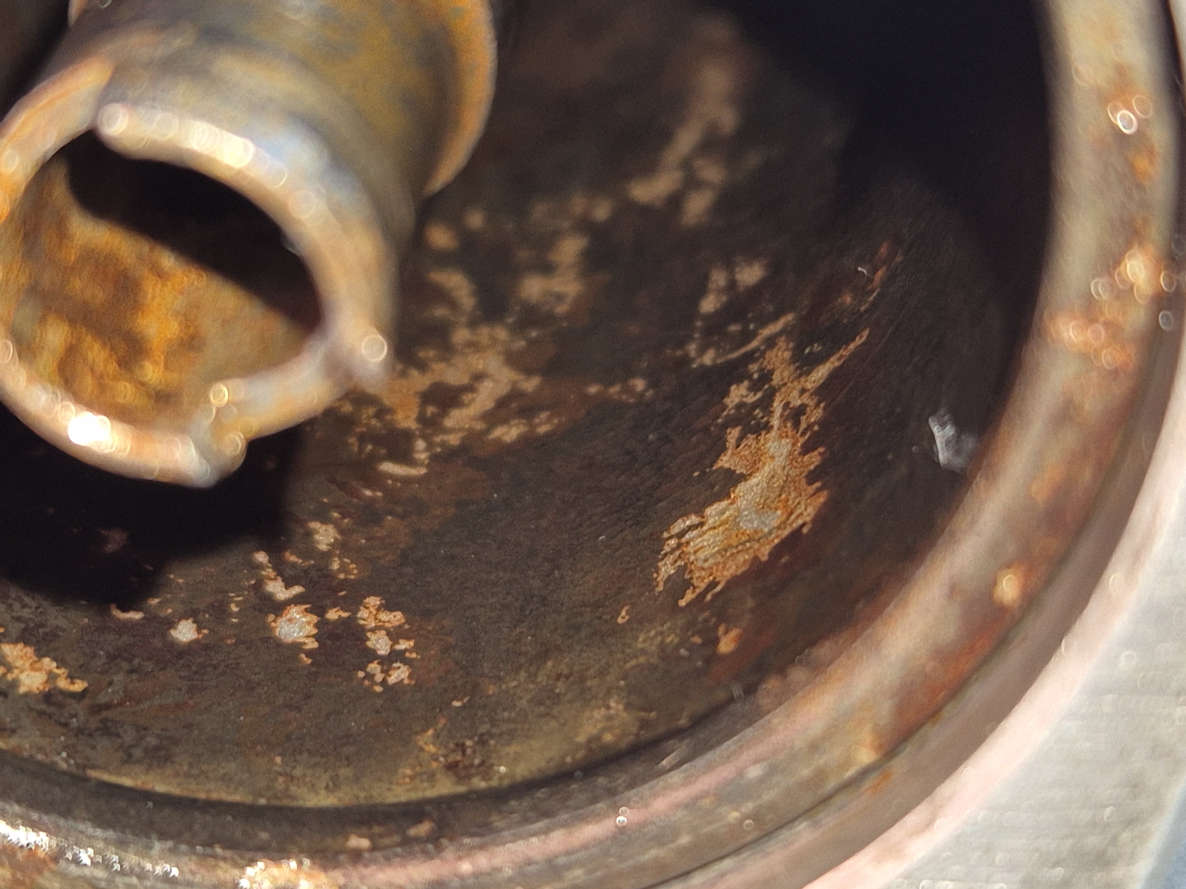

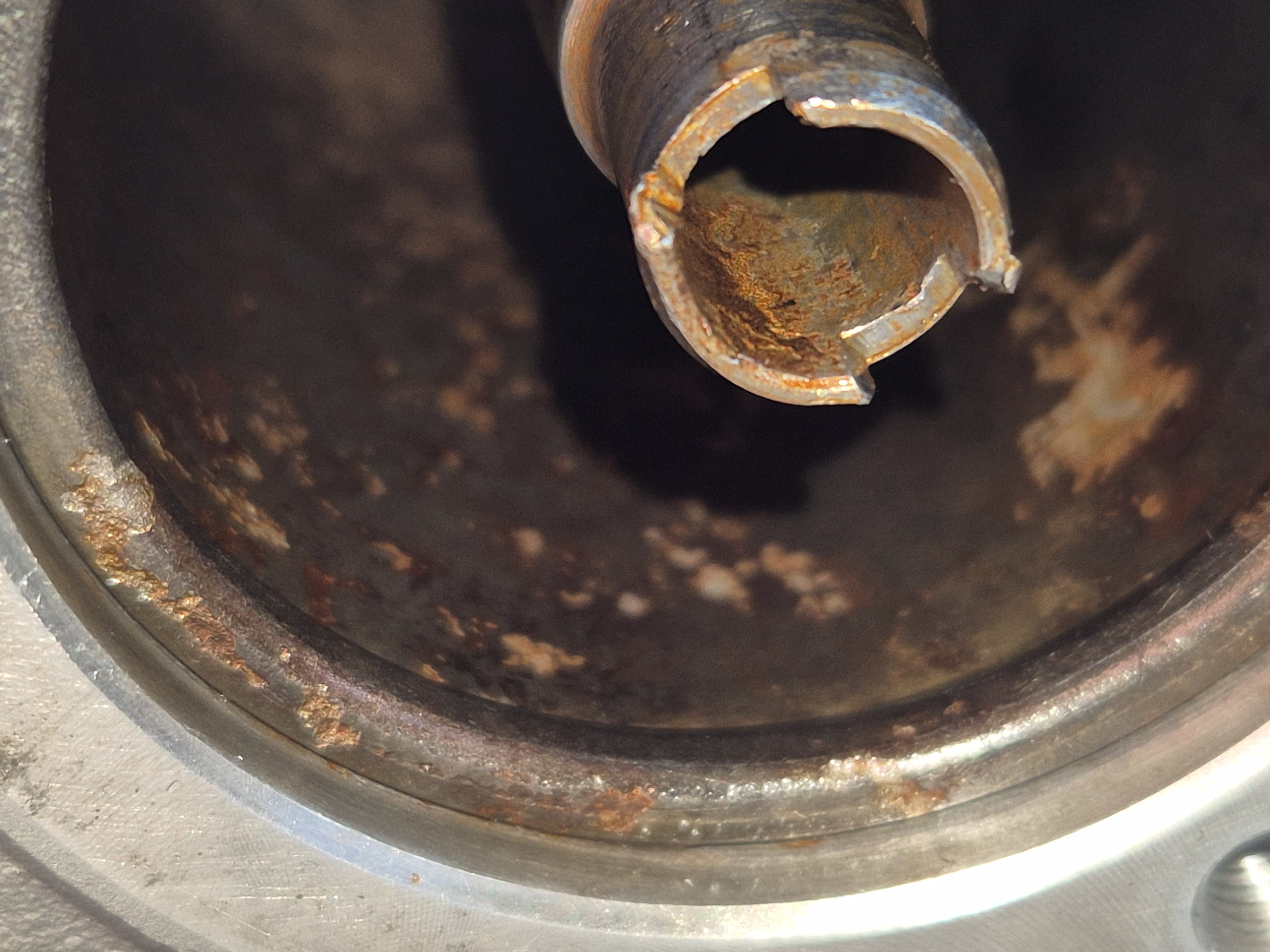

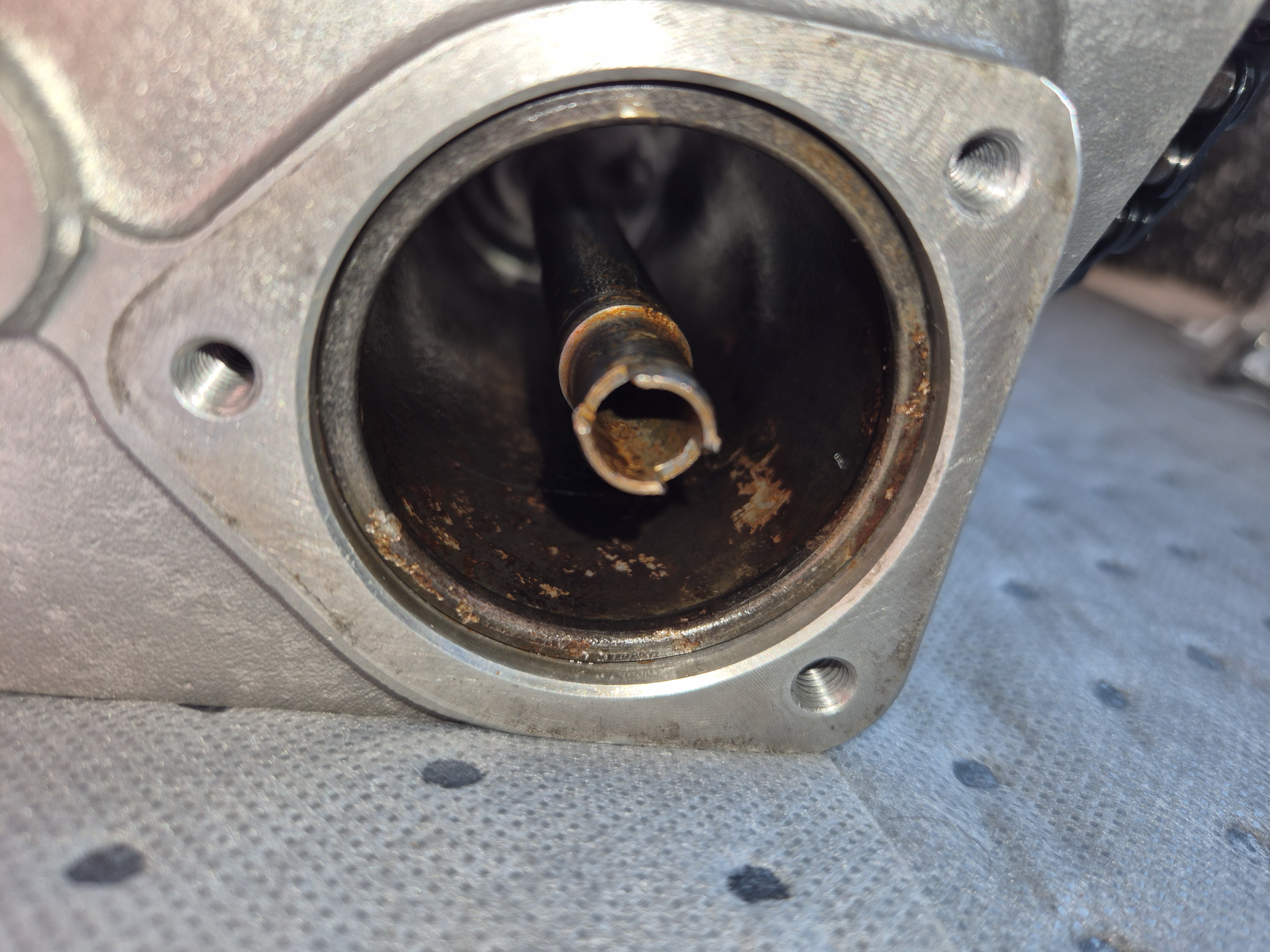

I cleaned off the rust a month ago and applied some WD40 to prevent further corrosion. There's some pitting on the mating surface for the o-ring and inside the canister itself. See pictures below. What do you think?

I wouldn't worry about that. Try removing a bit more crap with a wire brush and sandpaper and put a new metal shim for the surface the white o-ring sits on. You can get anal and measure the precise canister depth, but it looks fine to my eye.

I would certanly try to remove loose rust, particularly from the central tube as this is the 'engine' side of the filter. Not too worried about that on the outer canister... it's a filter after all. I would be more concerned about the pitting on the end of the outer cannister (as seen (particularly) in the second image). This joint is a seal under full pump pressure. Since this is one of the late models, which don't use the metal shim at this location, however, there is a good chance that the 'O' ring will take up these pits and seal. I would be inclined to assemble the engine and run it watching the pressure gauge. If there's any sign of low pressure stop and reconsider. It might also be an idea to put an oil pressure tester on it to make sure things are sealing. Replacing the outer canister isn't for the faint hearted...

The filter was actually installed with a shim when I bought the bike. I'll measure the depth when I get back to whe workshop. If I'm not mistaken I should be aiming for about 20% compression.
At first I was quite worried about the pitting on the edge of the canister. However, like Rob says, I believe the o-ring will provide sufficient sealing given the right amount of compression. After all, a shim (or even two) provides adequate sealing and I would imagine that metal-to-metal has lower sealing efficiency.

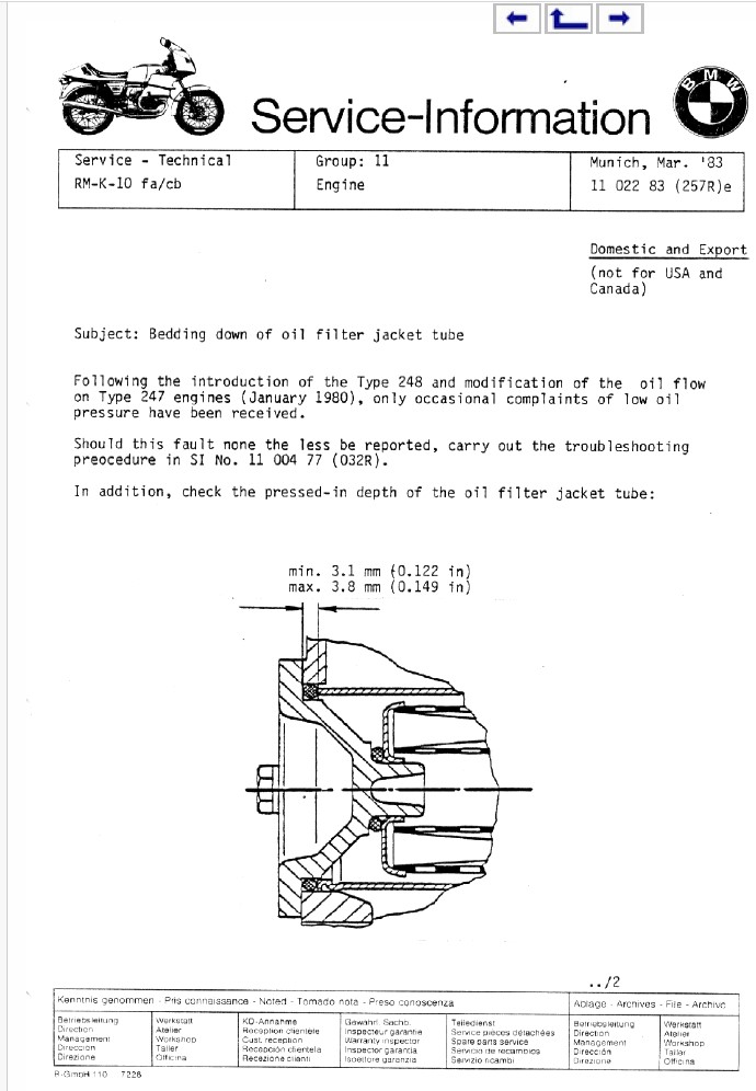

There 'should' be no depth issues with the later engines. The problem was only current for a short period and had been addressed by the time the Mono engines were issued. Still worth checking though... who knows what has happened to the engine in the intervening period.
I haven't really thought about it before but I can see no reason not to put a shim between the 'O' ring and the cover if depth is critical and you want to put a bit of extra pressure on the 'O' ring. The seal of the 'O' ring is made by compressing it against the end of the canister, the side of the hole on the crankcase and the inward protrusion of the cover. The contact with the face of the cover, where the shim would go, is not really relevant as no oil should get that far. Given the condition of the face on the canister, I would assemble the cover as it stands without a shim, start the engine (giving attention to the oil lamp... if that stays lit switch off immediately). then I would check the oil pressure with a pressure tester to be on the safe side. Any tendency for the oil pressure lamp to come on with the engine running should lead to further investigation...
I am attaching a copy of the BMW bulletin regarding the canister depth issue. (I don't have a copy of Bulletin 11 004 77 (032R) . if anyone has a copy I'd be grateful if they'd let me have a scan).
