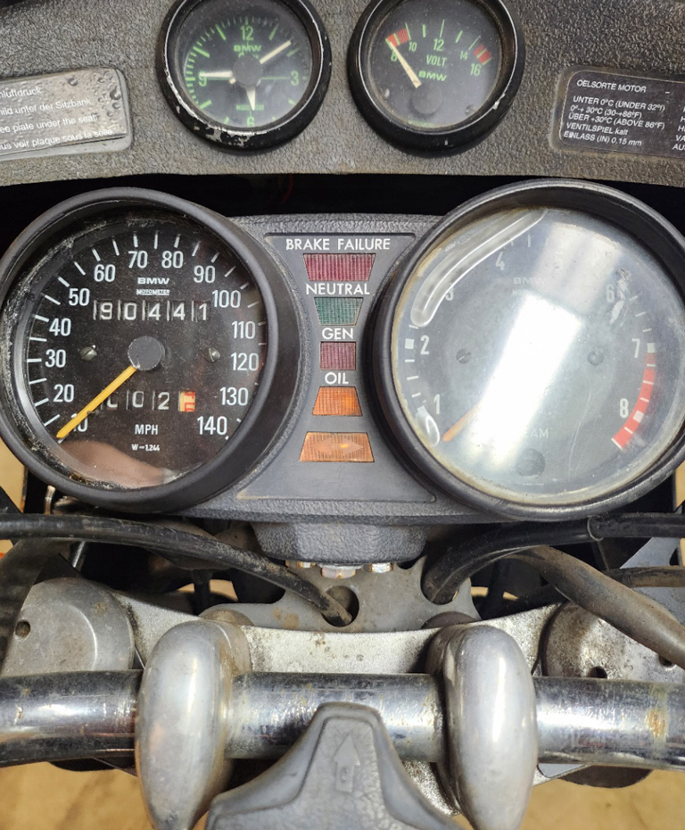

I was looking for an instrument housing to replace the one I have on my 74 R60/6.
It's an earlier year build (5-74) and has the older switchgear which may have no bearing on the subject.
I have discovered looking about that all the clusters I see have the turn indicator on the top and either brake fail or bright lights on the bottom, while mine has the brake fail on the top and turn indicator on the bottom.
When did they go away from the turn indicator on the bottom of the cluster?
Jim

I offered some thoughts on the other Vintage forum. I'm wondering if the change was for the 1978 models with the electronic tach.
Re: Differences in Airhead speedometer housings
Go to www.katdash.com and open the different slash series tabs...pictures and dates..
Amber turn signals at the bottom to 9/77.
Green turn signals at the top with brake failure light at the bottom and blue high beam in the tacho from 10/77 t0 9/80.
Green turn signals at the top, high beam at the bottom and no brake failure light...10/80-end of 95.

I suppose the dates can be a bit fuzzy. My 9/77 build R100/7 has the turn signal at the top.

FWIW, My '76 R60/6 has the Brake Failure lamp at the top. Suggestion is that it moved with the change to the /7 but there could well have been a bleed over datewise...

My 1978 R80/7 has indicators at the top and Brake Fail at the bottom, I also have the electronic rev counter.
