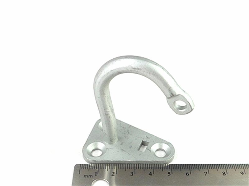

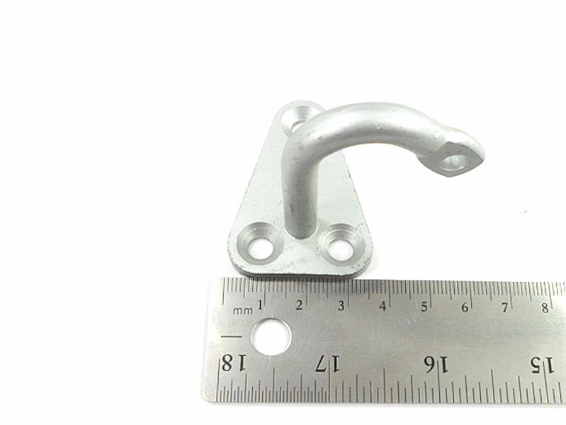

In an effort to understand the difference I had a look at the fiche.
They list and picture the same hinges for bikes from /5 to RT. I know that's not right as a mates /5 isn't the same...
Image Image
Cross referencing to the 75/5 pn 52 53 1 236 351 is the rear hinge and has the same picture as above.
pn 52 53 1 230 314 is the front hinge and is also the same as above.
So, if they're different through the models from /5 to RT, does this mean that
1. the fiche is missing something :?: or
2. they'll retrofit all :?:
Is it one of those anomalies we seem to come across occasionally in the fiche :!:

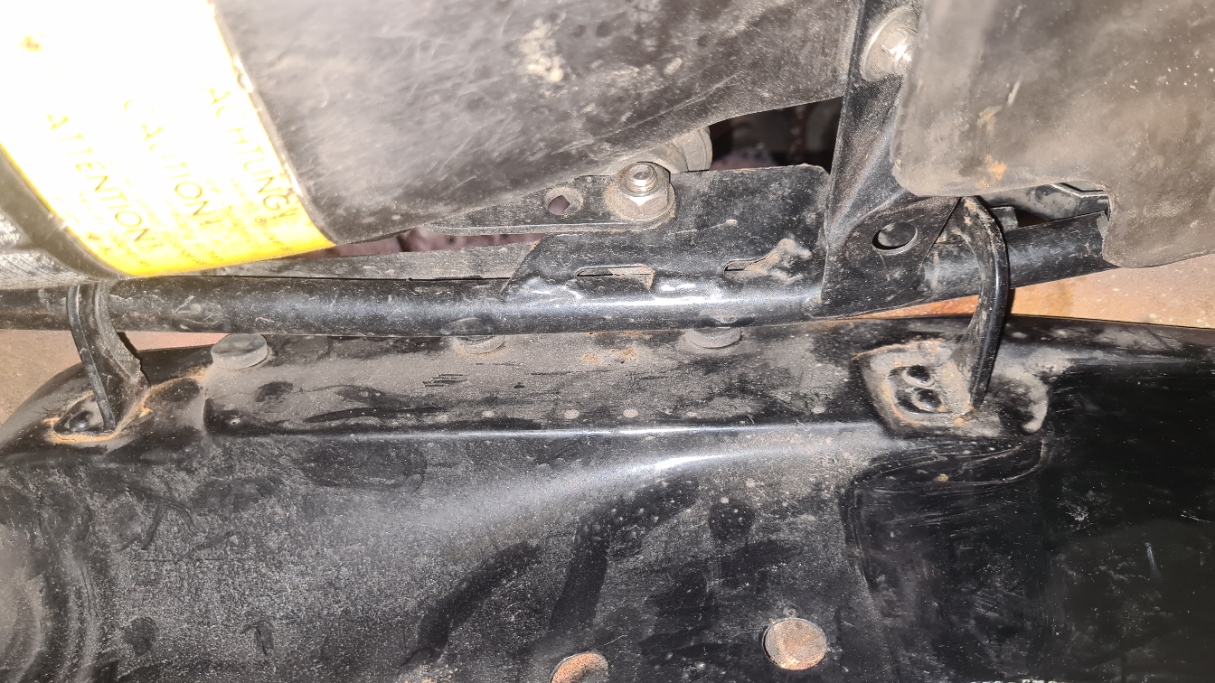

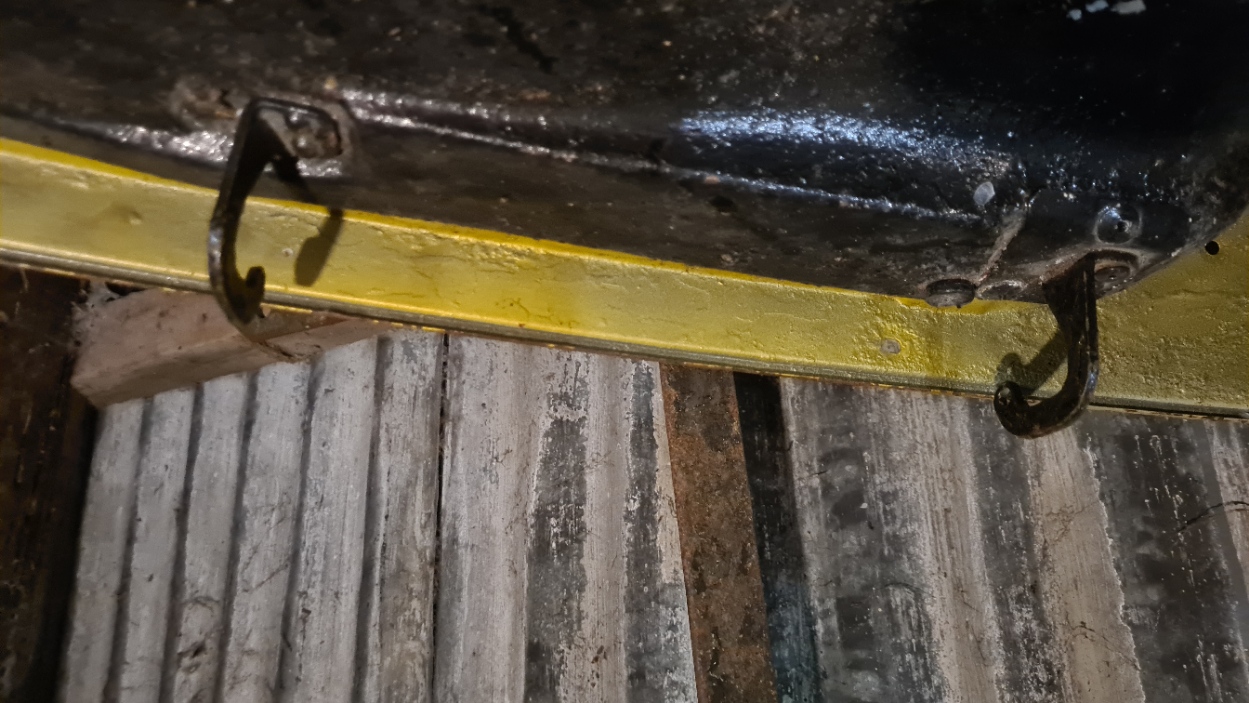

OK, I've added a few images of seat hinges below...
As a general rule, the hinge arrangement was common for all models of the same year... even when the seats were different. Bear in that BMW often changed the physical appearance of parts without changing the functionality...
1969 - 1980 (I think) - The hinges were as shown on the fiche. There may have been a version made out of flat plate by BMW but they appear functionally the same. The image is of my R60/6 which has plate hinges... but I can't be sure of they are OEM as the seat itself is aftermarket... The hinges are fixed with screws (confirmed form parts fiche).
1981 (I think)-1984 - Hinges are plate and fixed to the seat pan by rivets. The first image is a dual seat, the second from a 3/4 seat both on a '1981 RS. FWIW, the same hinges listed against the earlier models are shown as replacement parts for these years as well... so presumably you have to drill out the rivets and re-drill for bolts.

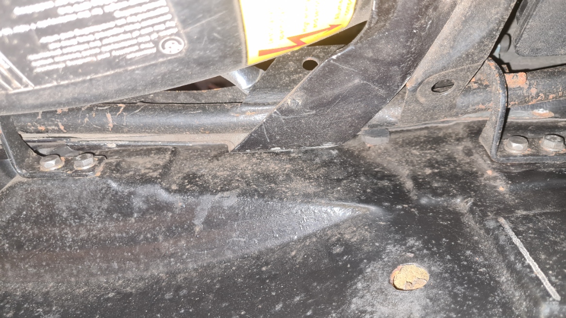

1985 - 1995 - Seat and Hinges are quite different. Made of plate and held to the seat pan with hex bolts.
(I can only attach 3 images to a post... will post the fourth image of a post '85 machine as a reply to this post)
Hope that helps
Posts: 1376
Re: R100RS seat removal
Additonal Image for 1985-1995 machines...

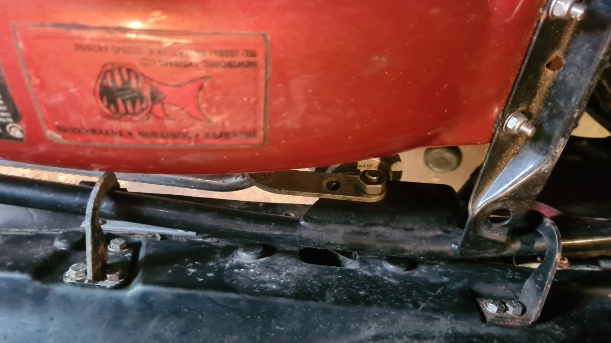

Here's mine - Oct 77 100RS, not sure if seat is original..
