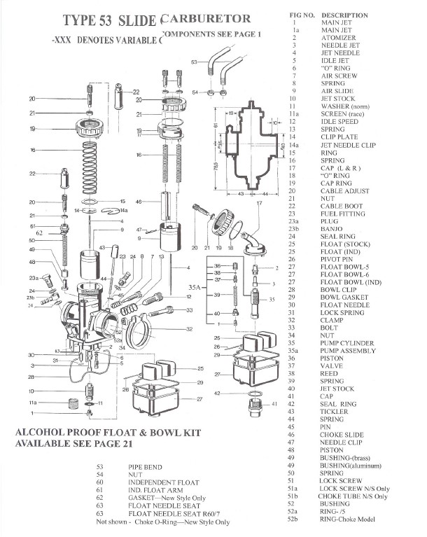

https://www.bingcarburetor.com/type53.html#/
Bing 53.jpg (111.9 KiB) Viewed 73646 times

Thanks for reply's. As you say a crude none return valve. An extra squirt of fuel just off idle as if the carburettor has an inherent flat/weak spot.
Re: R50/R60 accelerator pump
It's in the nature of slide carbs that they have an inherent flat stop when the throttle is opened. The accelerator pump seems a neat enough solution if it works well.

My understanding from memory is that there is a spring loaded element... can't remember off hand if it's a ball bearing or a slug of some other description... contained inside the main jet holder (accelerator pump or fuel pump in BMW speak).
It is below the level of fuel in the float bowl and is full of fuel.
The pump element is pushed down against the spring by the end of the slide needle when the throttle is closed.
As the slide rises, it is pushed up by the spring causing extra fuel to be pushed through the needle jet and into the venturi.
The result is that there is a brief enrichment of the mixture when the slide starts to rise giving a richer mixture off the idle and when the throttle is taken off the overun.
Crude but effective in overcoming the flat spot off idle and initial lean mixture when the throttle is opened.
