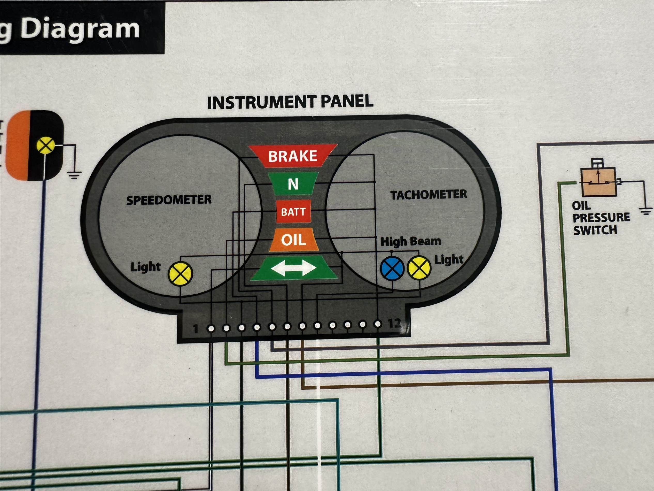

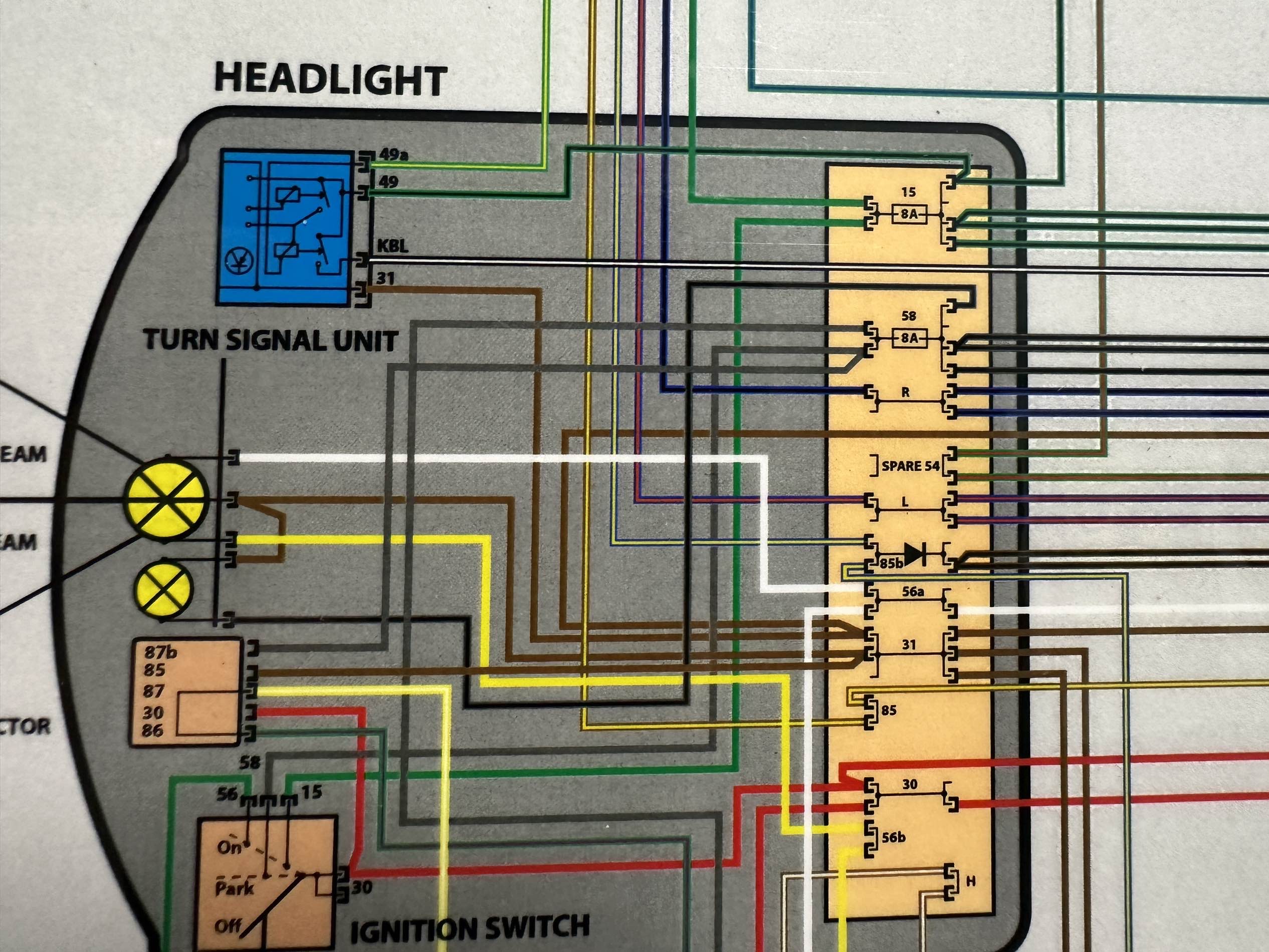

Relay and wiring diagram
- IMG_8259.jpeg (849.58 KiB) Viewed 10994 times
- IMG_8260.jpeg (739.58 KiB) Viewed 10994 times
1976 R75/6

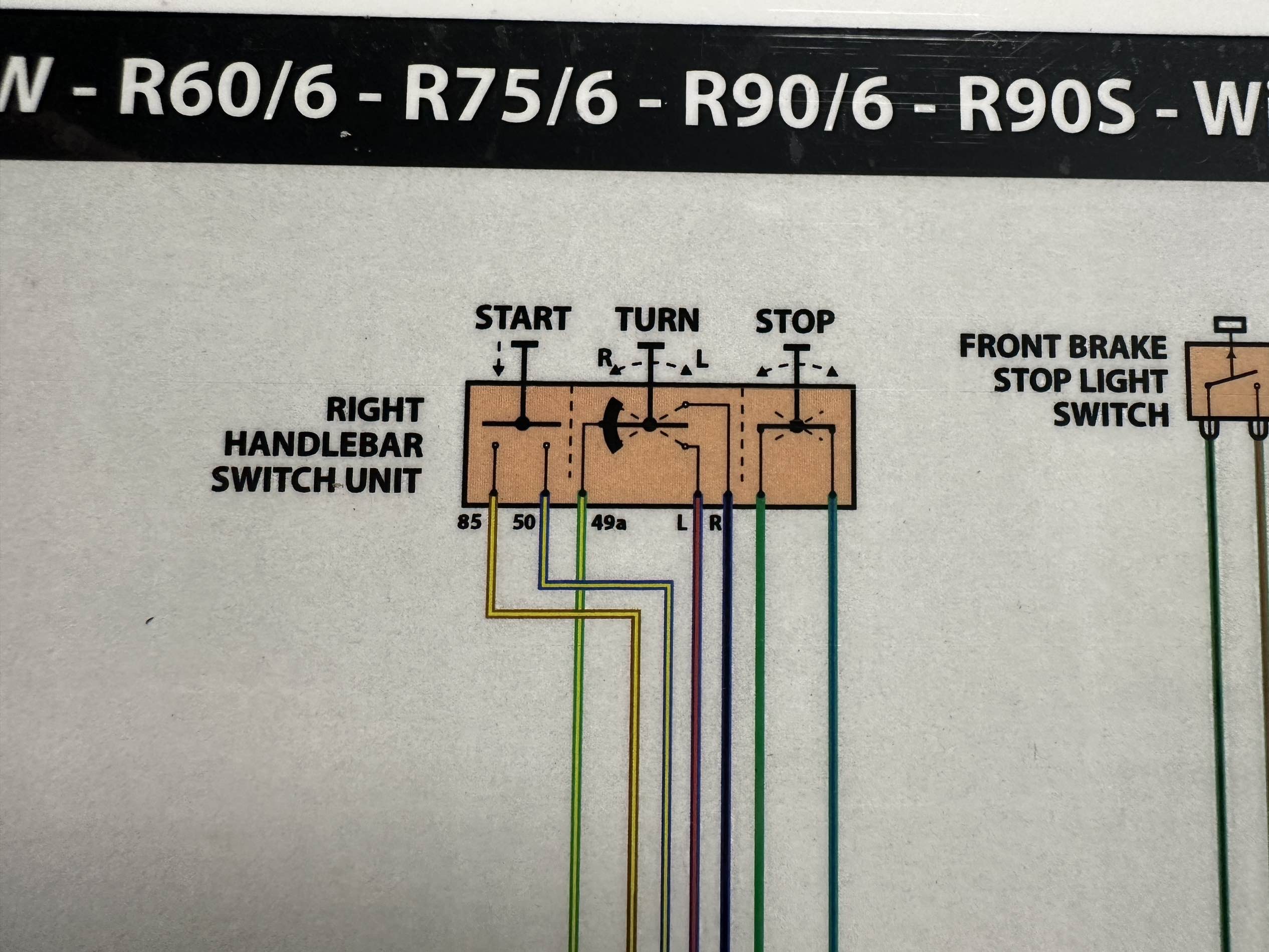

Re: R75/6 LED turn signals. Dash light won’t flash
More wiring diagram
- IMG_8257.jpeg (918.42 KiB) Viewed 10994 times
- IMG_8258.jpeg (721.02 KiB) Viewed 10994 times
1976 R75/6

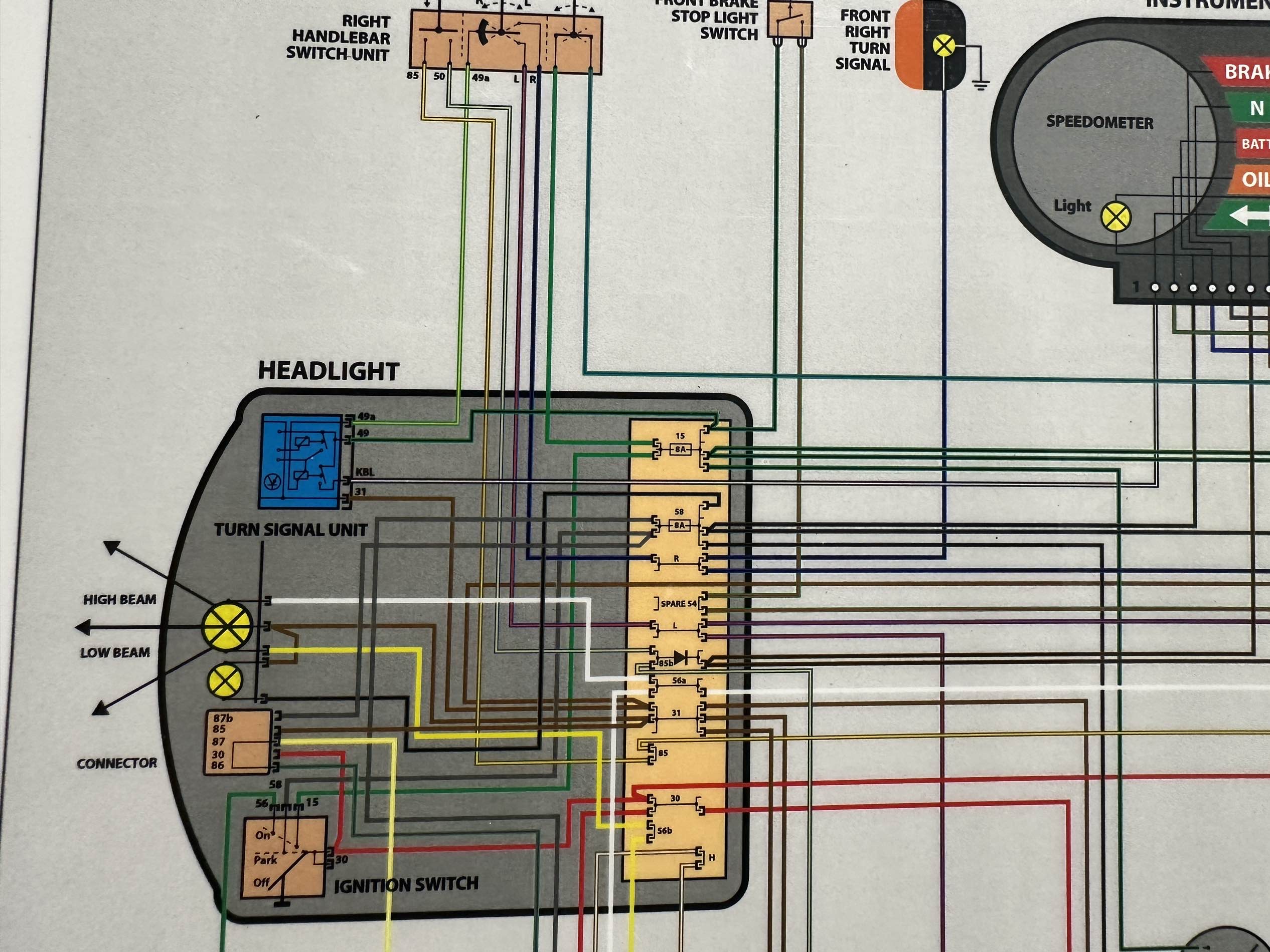

Last part of wiring diagram
- IMG_8256.jpeg (674.61 KiB) Viewed 10994 times
1976 R75/6

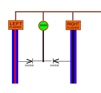

Do you want a cheap and easy fix to circumvent the problem?
Power the dash indicator bulb directly from the flasher hot leads. You’ll need two 1W diodes so the left side doesn’t power the right side and vice-versa. This minor surgery can easily be done from inside the headlight. You can get the diodes at any electronics store for a few cents each.
WARNING: This is not BMW (or anybody else) approved but will work perfectly and permanently.
What say you Rob F ?

GSPD - I like this solution. In experimenting last night, I used jumpers from the hot leads of the front turn signals to the wire for the dash light. With only the left or right jumper hooked up, the turn signals and dash light flashed correctly but with both jumpers hooked up, I had hazards, not turn signals.
I will order some 1W diodes today. Does it matter what voltage I get? I see there are a lot of options.

Rectifier Diodes are rated are rated by voltage and current. The voltage is the reverse voltage that the diode will take before it fails i.e. the blocking voltage), the current is the maximum current the diode will carry in the forward direction. They aren't rated in watts and you can't infer a wattage by multiplying amps by volts since the two ratings refer to different conditions.
The 'diode' solution is perfectly viable and has been done many times both with LEDs and incandescent bulbs. In this case, the fourth terminal on the relay is redundant and should be left disconnected (but insulated).
The diodes are polarity conscious and must be included into the circuit in the right direction. The simplest solution is to place the diodes together with the white bands facing in the same direction and connect the wires from the banded ends together. Connect wires, to each of the non-banded ends a third to the connected wires from the banded ends. Insulate the resultant circuit making sure that none of the wires can short to each other. Connect the 'non- banded wires, one each of the left and right indicaor circuits and the third to the repeater. All of these connections can be made at the connection board in the headlamp shell. The diode 'assembly' is small enough and light enough to be tucked in among the wiring there.
I would recommend a diode with a forward current of 1 amp and a reverse voltage of 100 volts. The voltage may seem excessive but it's a safety factor to allow for voltage pulses on the 12 volt line. It's no bigger or more expenxive so there isn't a downside. The industry standard is probably a 1N4002. Google will recognise this numberand give you any number of suppliers... you'll probably find yourself buying ten for less than a single one. I'm seing prices for around 30 pence (say 50 cents) for ten... you can probably get cheaper than that if you look.
