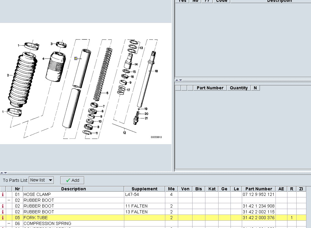

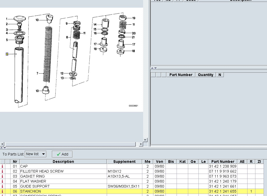

I'm sorry, I have to disagree. I think you're misreading the Parts Fiche. You need to look at the actual diagram for the vehicle concerned to get the full picture. Below are to images 'snipped' from the BMW ETK system which give the full story.Todd wrote: ↑Fri Dec 19, 2025 4:22 amAccording to the parts fiche, the fork tube or stanchion is 31421241655 (superseding 31429062419) and is found on the following vehicles:Rob Frankham wrote: ↑Thu Dec 18, 2025 6:53 amIn all cases, the forks legs (icluding sliders) are different both externally and in internal components. You can't intemix parts.
The same goes for the internal dampener, spring, yokes etc (with the R45/65 listed on some parts). The shaft seals are the same. We know it's the same diameter.
- R 60, R 75 , R 80, /7, RT (76-85) (04/1977 — 01/1985)
R 65 GS, R 80 G/S, R 80 ST (80-92) (05/1980 — 07/1987)
R 100, /7, /T, CS, RS, RT, S (76-84) (03/1976 — 11/1984)
As far as I can see, there's no reason why a late-1980s to 1984 twin shock slider cannot bolt straight on to an early-1980 fork tube. That would allow the twin pot Brembos to fit and then, as you suggest, an adapter to fit other calipers ... depending on clearance. You can see there's not much space between them.
You will see that the first image shows the number as 31 42 2 000 376 clealy markes 'Bis 09/80' translated 'before 09/80'. The second image shows 31 42 1 241 655 clearly marked 'Von 09/80'. translated 'From 09/80'. You can also see that the internals are very very different and similarly marked as 'before' or 'after 09/80'. In addition, although they aren't shown in these diagrams, the attachment of the damper valve at the bottom of the slider is quite different.
I'm afraid I have to re-iterate that you can't simply put Brembo sliders onto the earlier stanchions.
