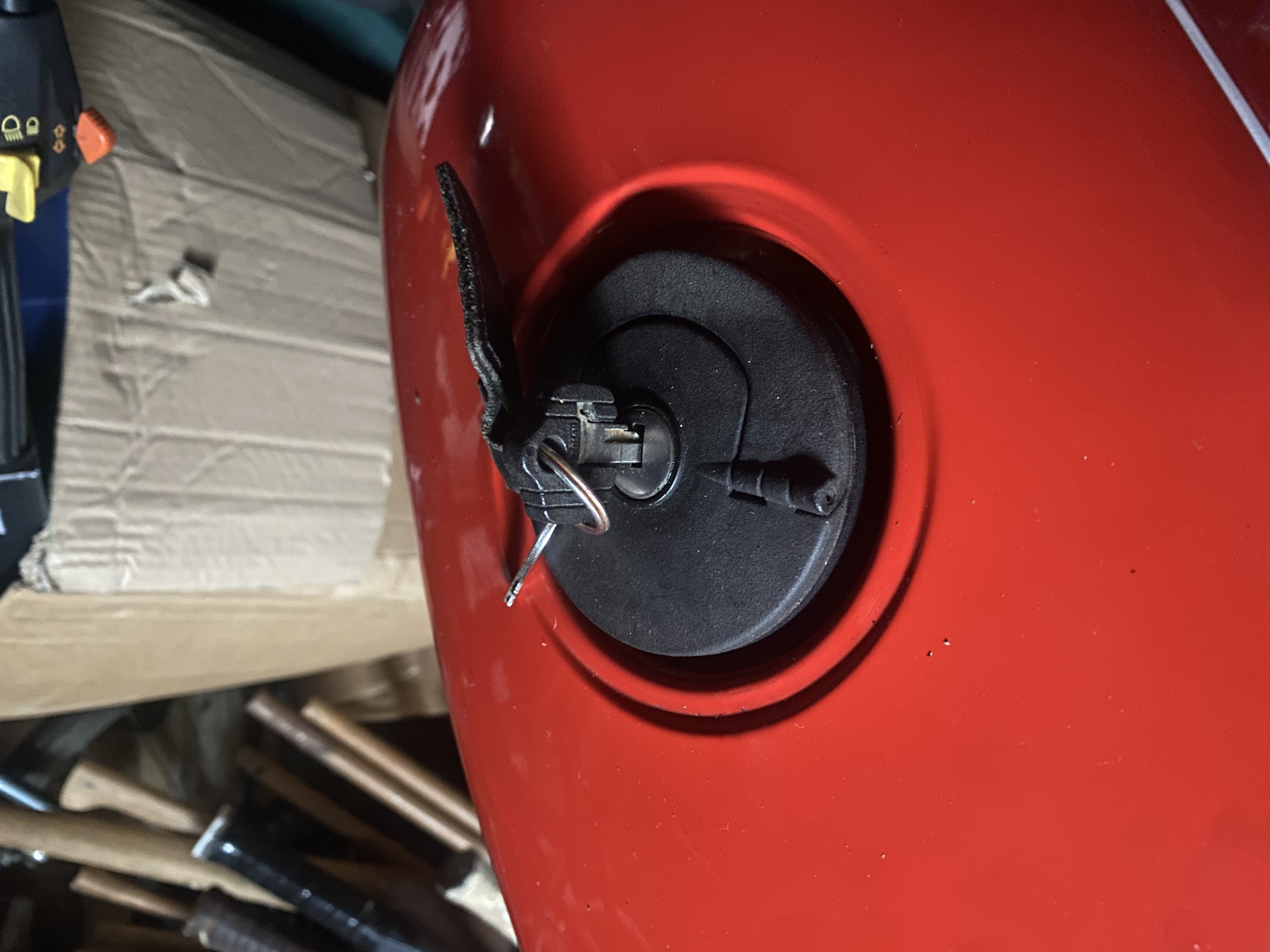

Hiya, I've just bought a 1986 R65 which has been sitting unused for over 10 years. I need to check the condition of the interior of the fuel tank but unfortunately it seems that the last owner left the fuel cap locked and i cannot get it to unlock. Despite my best efforts the key will not go into the lock more than a few mm. So, as the plastic cap (which has no BMW logo) just spins is my best way of getting the fuel cap off to do this hole drill trick described on the largaider site?

tobster57 wrote: Tue Jan 13, 2026 10:34 am ...left the fuel cap locked and i cannot get it to unlock. Despite my best efforts the key will not go into the lock more than a few mm. So, as the plastic cap (which has no BMW logo) ...
Is it the oem cap? Pix?

Yes, I think so. I’ve managed to remove the outer ring.

Don't know what you're 'best efforts' are but if you haven't done so, I would certainly try injecting a good releasing fluid or penetrating oil directly into the lock, then leave it for a week, possibly adding more fluid daily. It's worth trying to free the lock rather than risking destroying the cap. There are a couple of established ways of removing the cap if it's impossible to shift it...
1) take a rope and loop it through the handle then stand on the footpegs, wrap the rope around your shoulders and use the muscles of your back and legs to force the top of the cap... This allows the inner plug to be unscrewed. The benefits of this are that it allows access to the lock mechanism and you may be able to free it up. The cap can normally be reassembled.
2) Drill a hole and insert a screw as described by Largiader and others. This allows you to unscrew the cap and allows you to continue to use it but not lock it.

Here's the cap deconstructed...it's press fitted together.
When refitting it, lining up those holes (if yours has them) and inserting a small self tapper will stop it from turning too, avoiding the screw from the top technique. The outer plastic ring covers it. Mine has been modded accordingly for over 20 years. Also, I never lock it.
