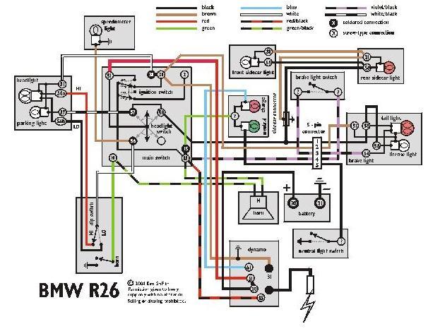

Can anyone direct me to a wiring diagram that shows the regulator connections in the dynamo? Mine is connected to terminals 61 and 51 and I would like to confirm that is correct. Still looking for causes of over-cooking my battery. thanks

I've not seen any diagrams from those days that actually show the regulator specific in the circuit. From the new Doug Rinckes book, you should have the F-type regulator or Noris regulator. There's no real diagram but it shows a wire coming off the coil affair which goes to the generator 61 while another wire (near the mechanical points) going to regulator 51 (and to the generator 30/51).

I have a diagram which may help.
I know nothing about the dark art of electrics on motorcycles so I hope that this is correct as it came from a good source.
- Diagram of wiring 1.jpg (58.84 KiB) Viewed 66527 times
