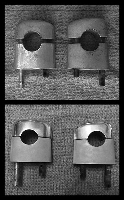

BMW does not utilize 7/8" bars, they are 22mm. 7/8" bars will not allow BMW perches to slide on unless you pry open your controls with a screwdriver which will likely cause micro stress fractures and ultimately break. The other alternative is to grind the handlebars. I learned this the hard way by being told by handlebar manufacturers "don't worry 7/8" is the same as 22mm". Well I have 3 pairs of handlebars in the corner of my garage that don't fit my BMW controls... I finally ordered a pair of 22mm Fehling bars from Germany.
Using 7/8" controls on actual BMW 22mm handlebars will require you tighten them down so hard they may fracture depending on what material they are made of.
I would suggest converting to 7/8" by using a drum sander attachment on a Dremel and carefully adjusting the contact area on your risers to ensure they aren't too tight (leaving a space at the top and the bottom). This is assuming you have your OEM risers). There are plenty of 7/8" aftermarket risers out there to choose from, you will be hard pressed to find 22mm aftermarket ones.

I can easily machine your handlebar clamps out to 7/8 but you would still have a problem with all your perch parts

I think no one is offering links to controls that will fit 22mm bars because there aren't any. Very few manufacturers use 22mm so there is no market for sales. You can get 7/8" controls to fit by taking your handlebars to a machinist and having them "knurl" your bars right where the new controls clamp on (where the tightening bolt is), then a couple strips of heavy (commercial) aluminum foil wrapped around the knurled area will give the controls something to grip on. This fix will be invisible if done carefully and should be safe as long as you test it good by trying to spin the control perch pretty hard to verify good traction.
With 7/8" your choices will be virtually unlimited.

How about drilling out the bar rises to support 7/8" bars, and then a master cylinder with the appropriate bores to match the calipers. Most clutch levers will work. BMW has both single and dual throttle cables. Old Triumph Bonnevilles had dual cable throttles, so you can try using one of them. Cables are pretty easy to make up.
