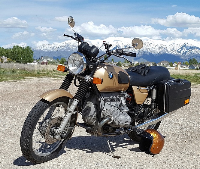

Here are a few photos of the bike.

- 1976 BMW First Ride resized.jpg (214.02 KiB) Viewed 4088 times

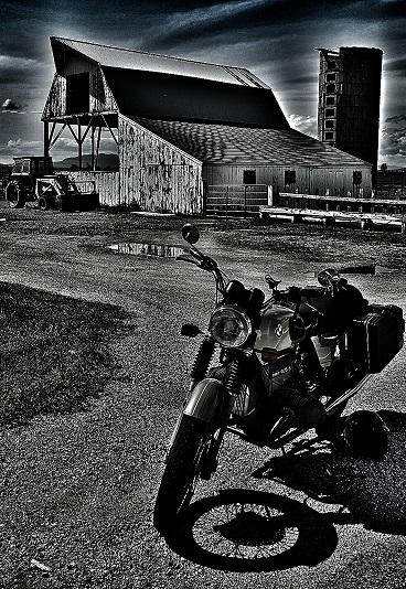

- 1976 BMW and barn-02-01.jpeg (138.24 KiB) Viewed 4088 times

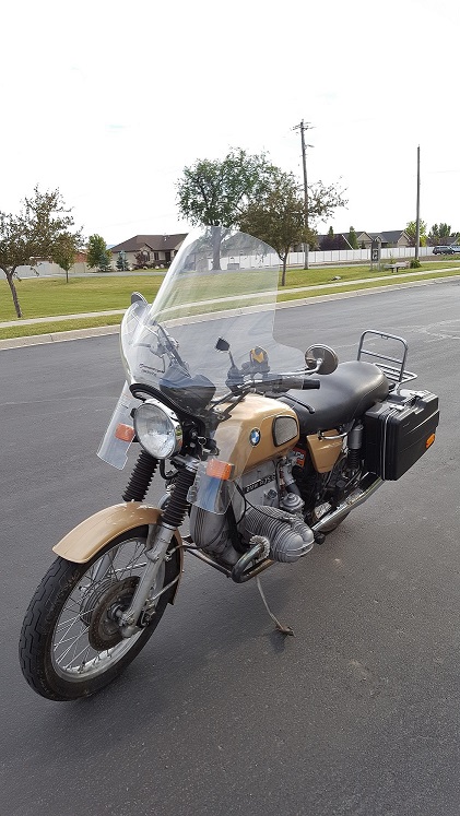

- Latest picture (While pushing the bike back home) shows the new windscreen and the freshly attached rear luggage rack.
- R75 061816a.jpg (145.4 KiB) Viewed 4088 times

Welcome and I love the bike... also that mountain in the back ground
