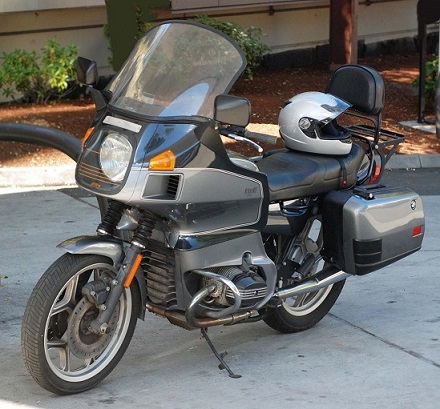

thought some of you could chime in and share your thoughts. i've owned several airheads and just sold my 1983 R100RT after purchasing my new to me 1995 R100RT w/19K miles - just fully serviced at dealer in california where i purchased it. the bike arrived to my home in seattle today and was unloaded at 10am.
i tried starting it and found it difficult - temperature about 65 degrees today and bike was last run about 2 weeks ago at dealership.
when starting, it requires the choke be on fully for a long period of time - and choke at full opened position, it needs to idle for at least 2 minutes before i can close the choke to the 1/2 way position - after another minute or 2 i can turn off the choke completely. *i really can't turn choke off and use the throttle until it has idled with the choke for this amount of time or bike will cut out and turn off. *after idling for a while this morning i turned it off and restarted about 2 hrs later - same scenario - needs choke for several minutes.
it's idling at about 800rpms and very quiet/consistent at that point after about 4 minutes.
*with my other R100's i would use the choke for about a minute and then pretty much be able to turn the choke completely off and the bike would respond to the throttle without cutting out.
does this sound strange at all??
thx in advance.

so heres the latest: i finally got time to take the bike out for a drive today (i turned idle adjustment screws up yesterday so the bike is idling at 1100rpms) and here is the procedure i used - 65 degrees today and sunny:
to start: cranks right over with full choke for 4 minutes with some throttle, then i am able to turn down choke to the off position *if i attempt to turn the choke off during the 4 minute time period the engine will cut out even if i attempt to use throttle.
after the 4 minute warm up period the bike idles perfectly - after a 45 minute ride around town the bike is idling perfect and all runs smooth. took it out again for an hour and just got home - bike runs really smooth and love the monoshock suspension - idle steady at 1100rpms
so basically it is just the amount of time it takes to turn the choke off. with my other RT's 81 R!00 and '83 R100, i use the choke for 30 seconds max and i can turn it off and use throttle.
since it has been recommended the carbs be gone thru, do you guys suggest i send them to BING and have them do the work? any idea of cost for BING to do them vs indy shop??
thx in advance!
thx in advance!
