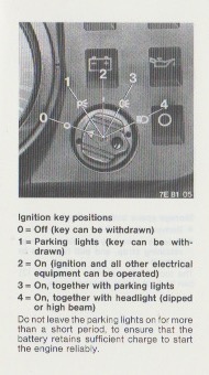

All models DO NOT have the same harness. There are slight differences (and part numbers) between the euro and non-euro harnesses, and also from year to year and model to model. Also, some ignition switches had up to 5 positions (off + 4). Pic below is from my original owner manual but my bike came with a 3 position (off + 2 positions) switch. go figure...
