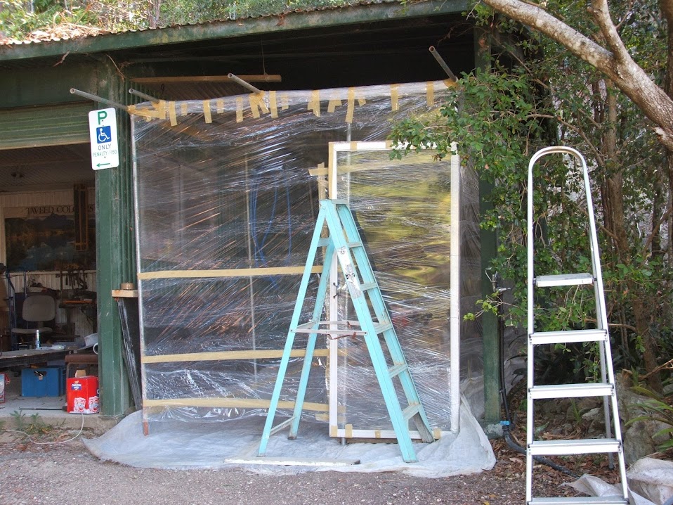

I have finally started what will be a long road of spray painting that will be broken into several sections done over a few months. Mainly because I have kicked the landlords car out of his carport so I could build a half decent spray booth under cover... on my unlimited budget I came up with this -
