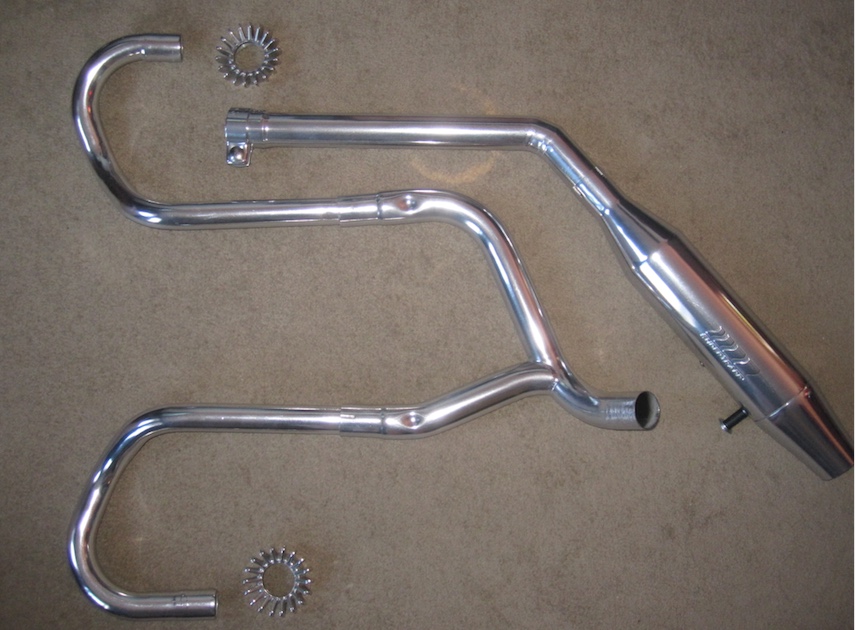

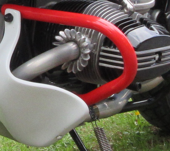

Exhaust ceramic chrome coating https://www.koolcoatceramiccoatings.com ... tings.html eliminates and prevents corrosion, and practically eliminates cleaning and maintenance. Dirt and mud just don't stick to it now. And it doesn't turn blue. Even after a tough day of 'mudding' just a quick wipe to dust it off and it looks like new again. Cost me about $300 to coat my complete exhaust. This coating holds the heat in (which is apparently a good thing) so I didn't coat the header nuts, I just filed off all the rough casting lines and polished them up.
Note: An area that is always hard to access and clean is around and behind the front exhaust crossover. As you have all observed, that's where all the crap thrown off the front tire accumulates and cooks on and it's a PITA to access and clean. I eliminated my crossover pipe decades ago. Those crossovers do very little (or nothing at all?) performance wise on a 2 into 1 system (see HPN) and their "overall performance benefit" can be somewhat debatable (but not here, not now) even on some 2 into 2 systems. The bike sounds way better (to my ears) without it anyway. The bottom pic is after about 80,000 km.

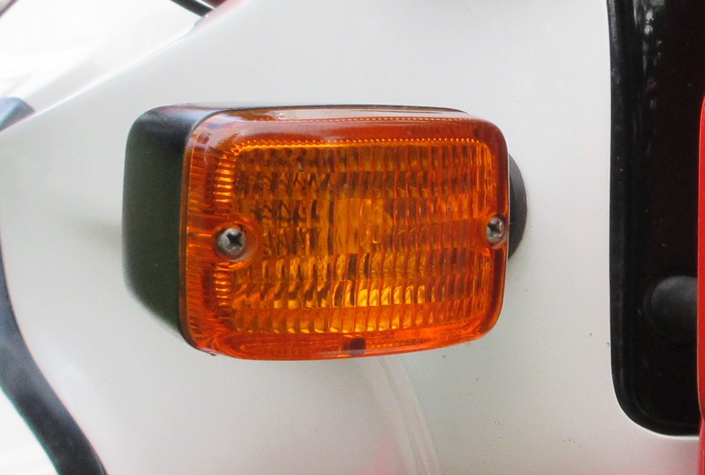

If you're oblivious or indifferent to typically dull flasher lenses with bug guts and dirt and wax crusted in around the raised emblem and letters, move along, nothing to see here. However, if you've ever cleaned your flashers lenses with a toothbrush, read on.
Disclaimer:
This one's not for the concours d'analgance crowd and could even possibly be frowned upon by your local Barney Fife wannabee.
End of disclaimer.
(drumroll please)
I removed all the raised letters and emblems from my plastic flasher and tail light lenses and polished them smooth.
Takes about ten minutes each, with a sharp X-acto, some 2000 grit and a bit of compound.
Makes the lenses really sparkle (and way easier to keep that way).
Nobody will notice. sigh. Just another brick in the wall.

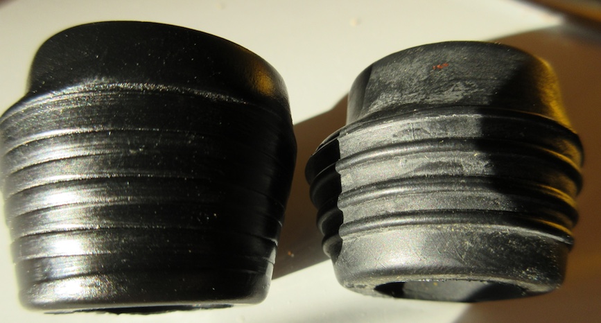

1) I noticed a slight sweat starting on the left side pushrod seals so I re-sealed the top end(s).
Everything was brand new in 2015, only 6 years and 95,000km have elapsed.
Most 'airheads' would have left it alone for another few years.
I took the time to give the valves a quick clean and lap while it was apart.
I also replaced the 1 large and 2 small base o-rings and both head gaskets.
Should stay nice and clean for a long while now.
PIC BELOW of a 6 year old 95k PR seal beside a brand new one.
Notice the ridges are flat on the old ones.
Size difference is due to camera angle.
The old ones feel like hard plastic, the new ones feel like yummy soft rubber.

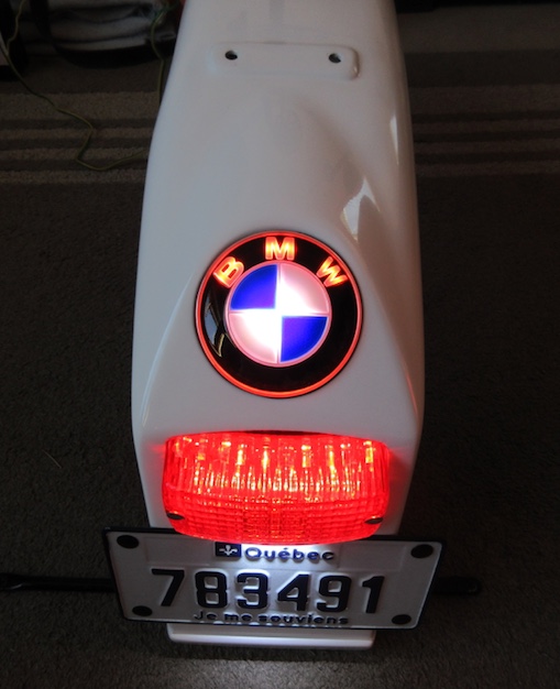

2) My rear fender had a few stone chips so I repainted it again for the umpteenth time in 30 years.
Toyota white is a perfect match.
Rattle can job, wet sanded and buffed to a mirror shine. Looks better than the ‘industrial’ paint job that came on GS’s from the factory.
Also up graded the LED lighting a bit.
$50 for paint and supplies.

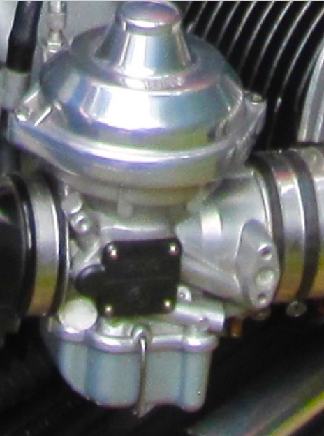

3) Rebuilt the carbs; This time I just replaced the float bowl gaskets and all the o-rings.
I totally rebuilt my carbs in 2011, 10 years and 135,000km have elapsed.
I have new floats, needle valves and diaphragms in stock but the 10 year old ones still work perfectly and look new so I didn’t replace them this time. I’ve never had a ‘on the road’ carb failure but I always carry spare float, needle valve and diaphragm in my emergency kit just in case.
$40 parts.
