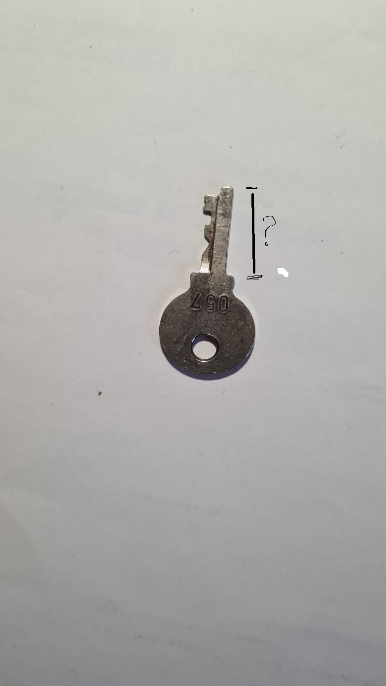

Would one of you be able to supply me with the dimension indicated in the attached?
My plan is to try and buy a blank from my local locksmith as a starting point and then start whittling away at it to match Rob's 057 photo in the hope that the tolerances are that slack they will make up for my amateurish attempts.

The length is 18mm. However, only the 5mm tip of the key enters the lock.
The rest of the keyway doesn't need shaping at all. Just the 5mm tip if you can find the correct profiled key blank.

I'm pleased to report I've had some success. A Yale ya27 blank from a locksmith had a similar profile to Rob's 057 key and after some grinding and filing I got it to open both a 057 and 054 lock. Unfortunately the width of the "tab" was a bit thin and snapped off! Fortunately you informed me only the first 5mm counts so I had enough of the key left to have another go. Out of 4x054 locks and 2x057 locks my second attempt fits 5 out of the 6. I'll take that for now.
